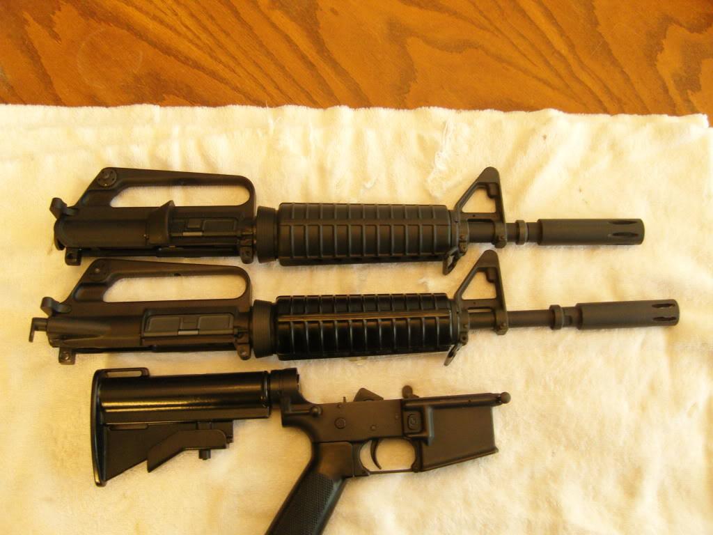

    Well, I finished my retro XM177E2 / CAR15 lightweight Carbine! Talk about a nice, lightweight weapon!!! With the standard M16A1 birdcage FH on the 16" barrel, it weighed in at 5.7 lbs. empty on the postal scale. My heavier "reverse" slip over XM177 flash Hider needs the rear blast washer re-attached before I mount it. Preliminary photos tomorrow when I can take them in the daylight.
    -S&W M&P 15 Lower, receiver treated with dark gray Rustoleum primer to match upper
    -M16A1 Colt upper with tear drop forward assist
    -COLT/USGI early non-tapered slip ring to retain handguards
    -ER Shaw (Model 1 Sales) 16" pencil CAR15 barrel 1/9 twist
    -DPMS lower parts kit
    -DPMS M16 bolt carrier group (I like the additional mass for feeding)
    -DPMS charging handle
    -DPMS CAR buffer
    -DPMS CAR gas tube
    -USGI M16A1 pistol Grip (NOS)
    -USGI M4 buffer spring
    -Rock River Arms CAR-15 handguards w/heatshields
    -4 position fiberlite CAR stock (unk. maker) with USGI castle nut and receiver plate
    -Either faux XM177E2 slip over flash hider or M16A1 FH: depending if I am going like the XM177E2 I carried as a LEO or a GAU-5/P as Air Force Security Police (reserves).
    -USGI 20 and/or 30 round aluminum magazines
    I have a Vietnam era M14icon/M16 OD nylon sling en-route.

    01:31 PM
    Red face
    Here is a lousy low-light flash picture. Just wanted to prove I really did it! My digital camera SUCKS on low light. If I can ever get time for me before the sun is too low in the sky, I will do a series of shots that better show color. I forgot to mention the M16A1 pistol grip is NOS still in the wrapper from Bill Rica. "C" marked inside. The comic book cleaning manual is an original I grabbed in the early 70s when I was in the service.

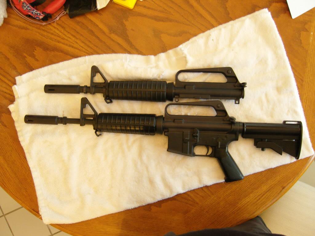

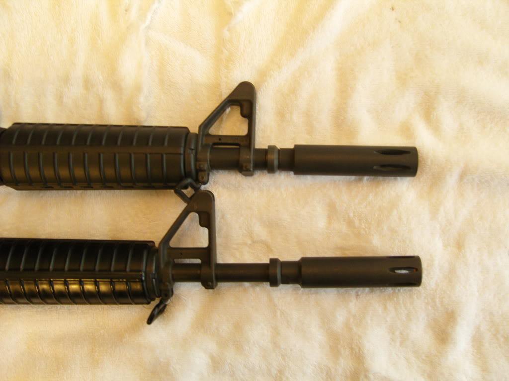

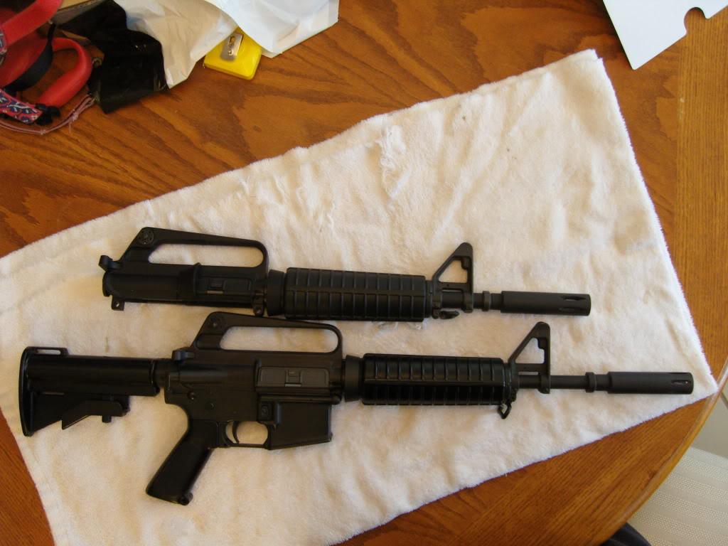

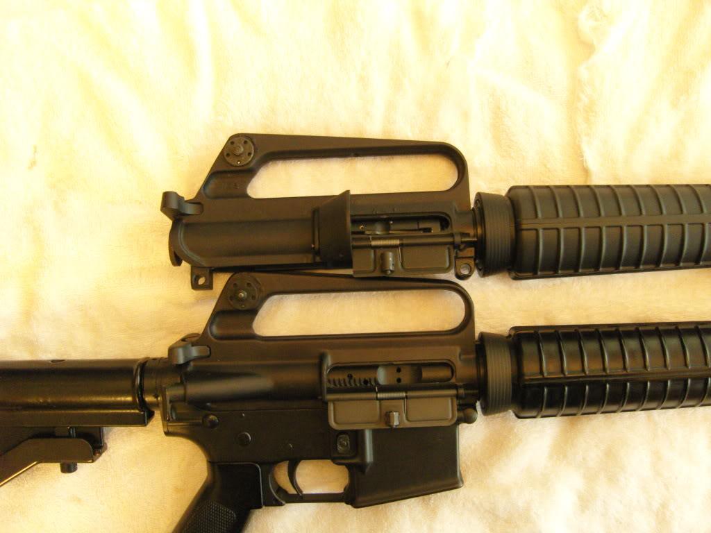

    Better pictures show color
    Here are a couple better daylight pics of the XM177E2 wearing a Colt 4X scope clone with BDC for M193 ammo. The upper is the original, later medium-dark gray pakerized and the S&W lower is coated with Rustoleum dark gray automotive primer. The picture shows that it is a pretty darn close match.
