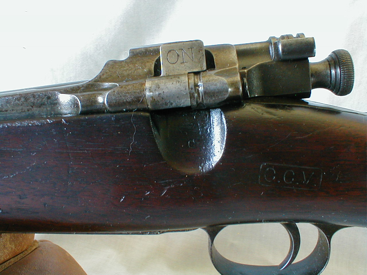

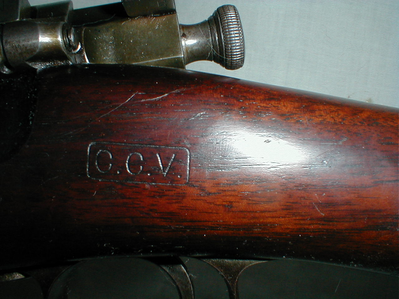

    Legacy Member RCS's Avatar
    Today @ 09:41 PM
    4,332
    Robert Seccombe
    05-24-2024
    09:16 PM
    photos of C.C.V. cartouche
    here are some photos of a CCV cartouche on a early SA 1903 stock
