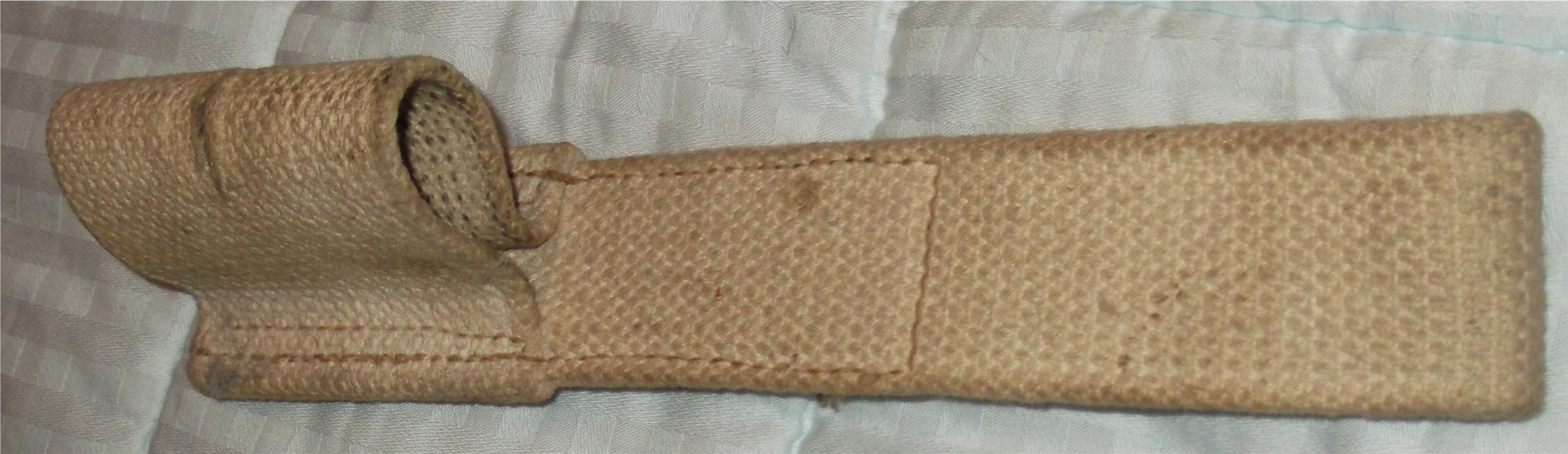

    The No.6 frog was introduced for the No.9 bayonet in 1954, with only a single loop, and the slit made wide enough for the frog button to pass through. White versions were made for the Navy and for the Household Division.
Name:	No 5 scabbard frog.jpg‎
