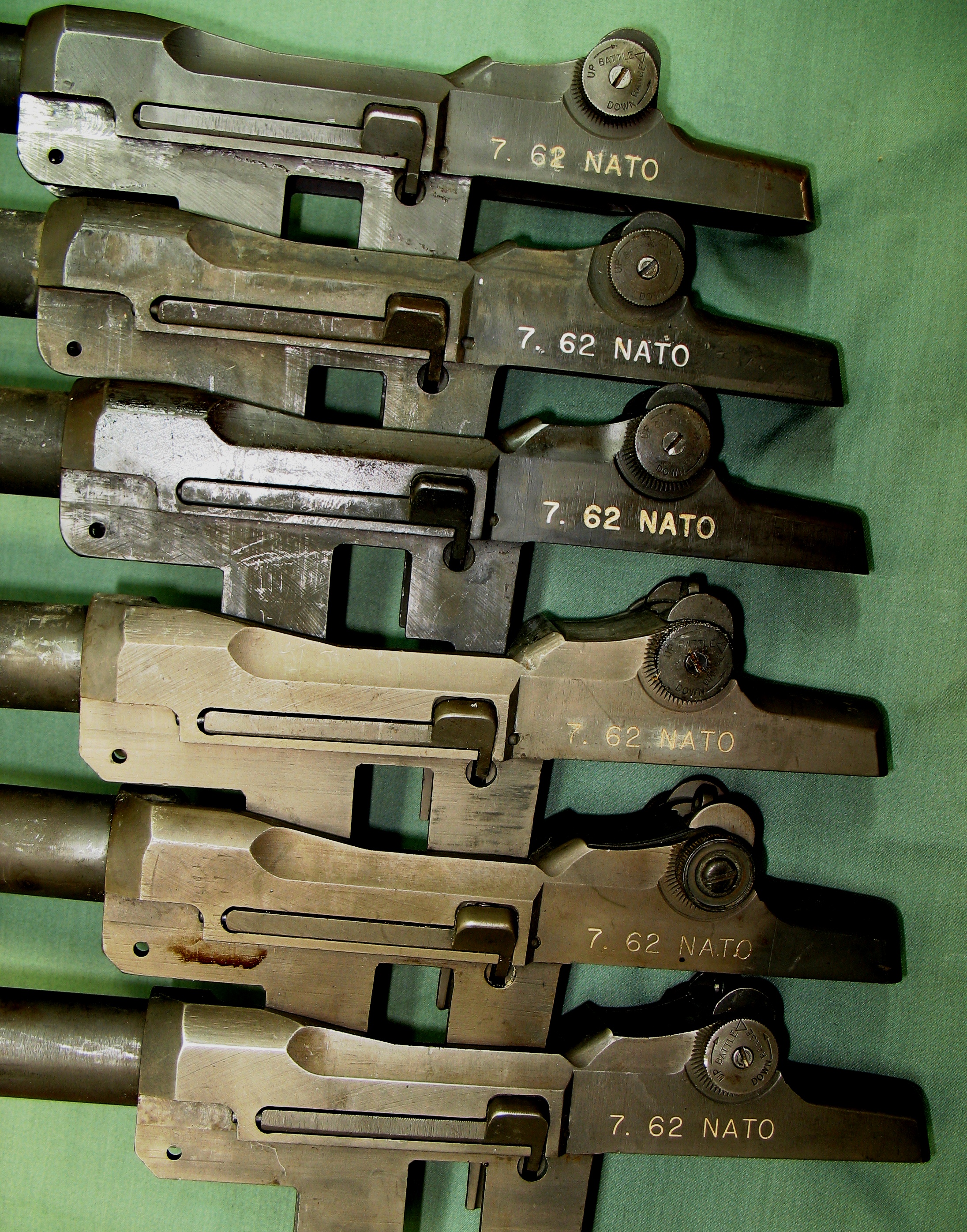

    7.62 Receivers
    From the 2012 article:
    "Of particular significance is the fact that none of these receivers
    had a barrel with 7.62 MM marking. The implication is that the
    initial intention was to mark only the receivers, not the barrel.
    Although that would allow the user to see the right cartridge for
    the rifle at a glance, it consigned that receiver to only that cartridge
    forever. If another caliber arose in the future or if it became
    necessary to put the rifle back to .30-06 for some reason, simply
    putting on a different barrel would not suffice. Besides, it wasn’t
    the receiver that was 7.62, it was the barrel. This was evidently
    realized after only a small number of conversions (reportedly the
    first 100), and marking the receiver was discontinued."

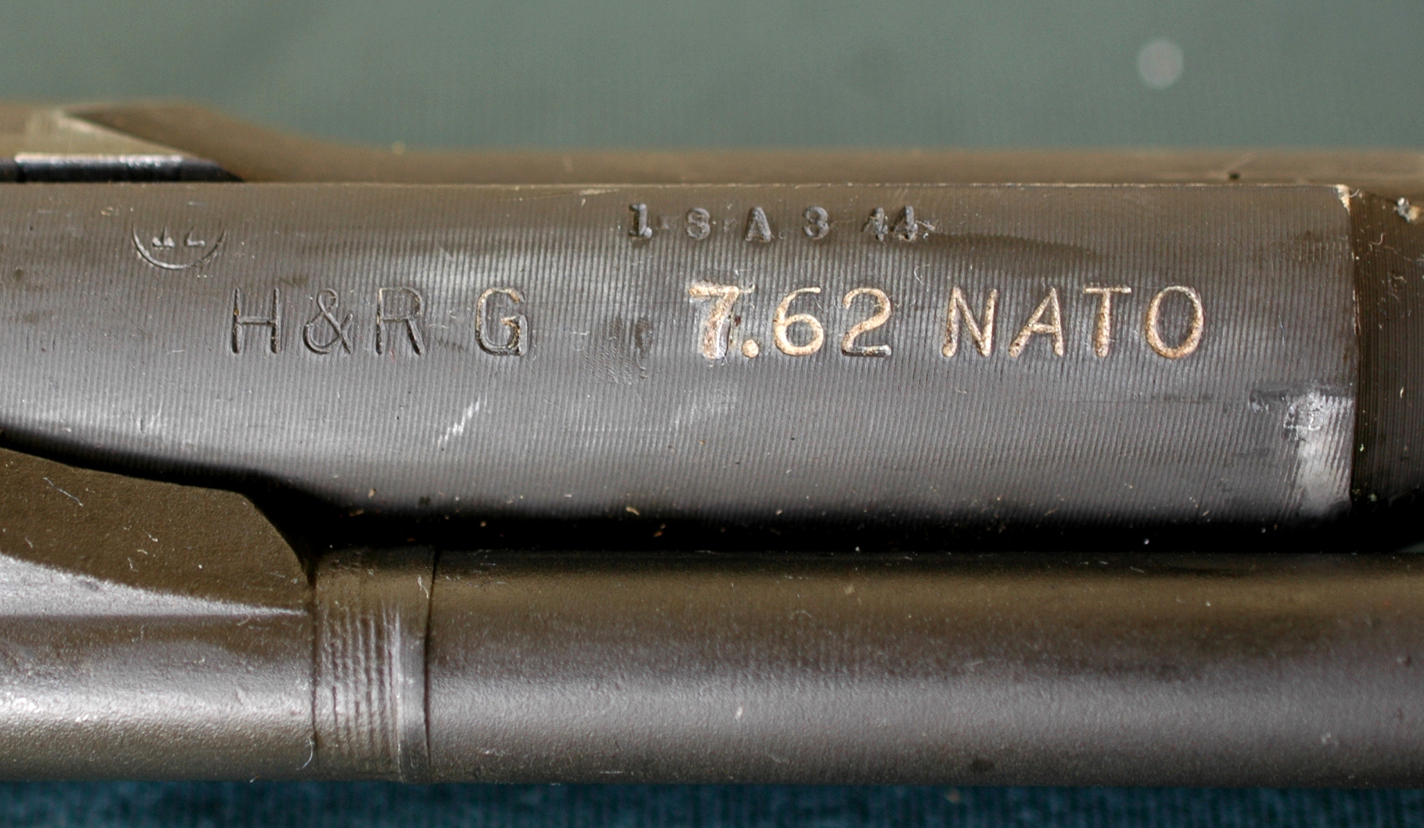

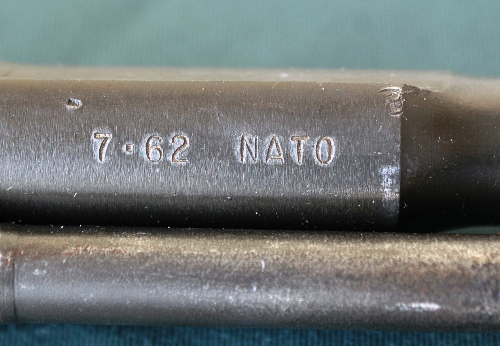

    Conversion Contracts
    The two companies contracted were American Machine & Foundry and H&R... we found many different marking schemes, including some with no contractor identified. Eventually we figured out that the quickest way to tell was the location of the decimal point in 7.62: HRA stamped it at the bottom of the line, AMF put it in the middle.
