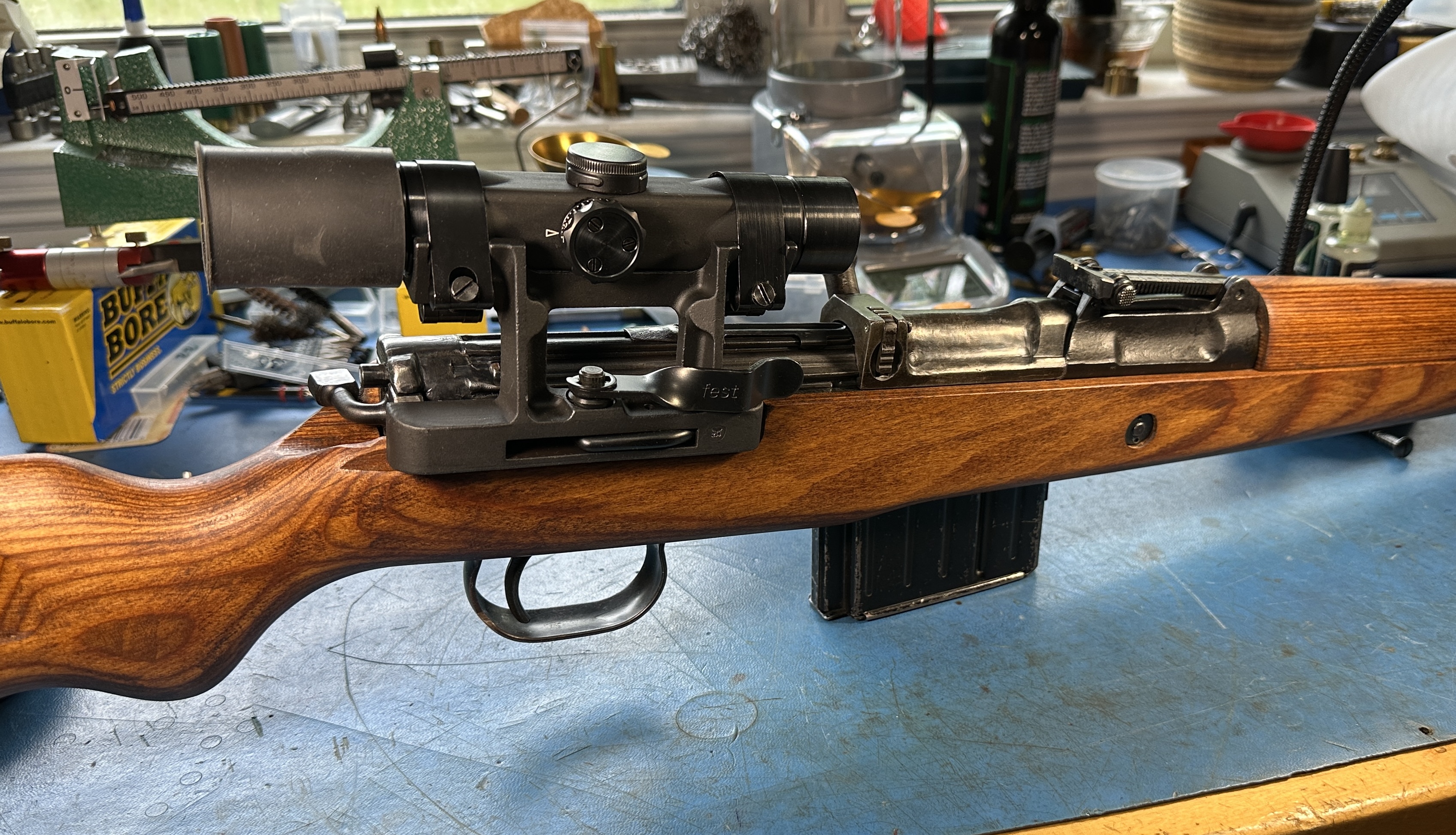

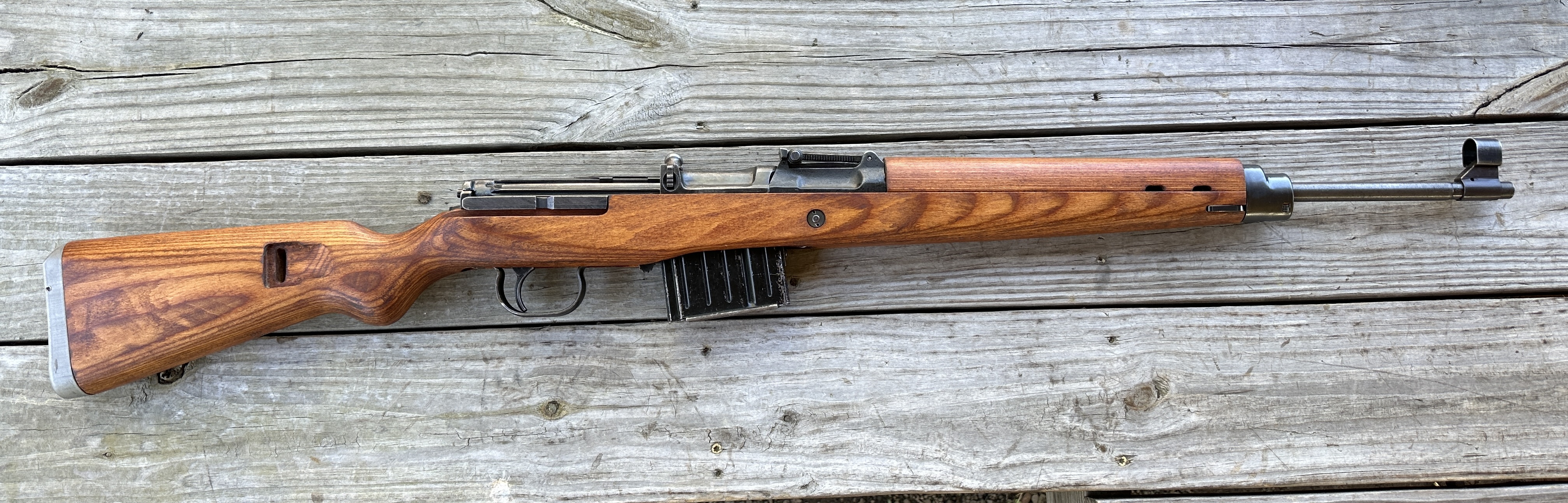

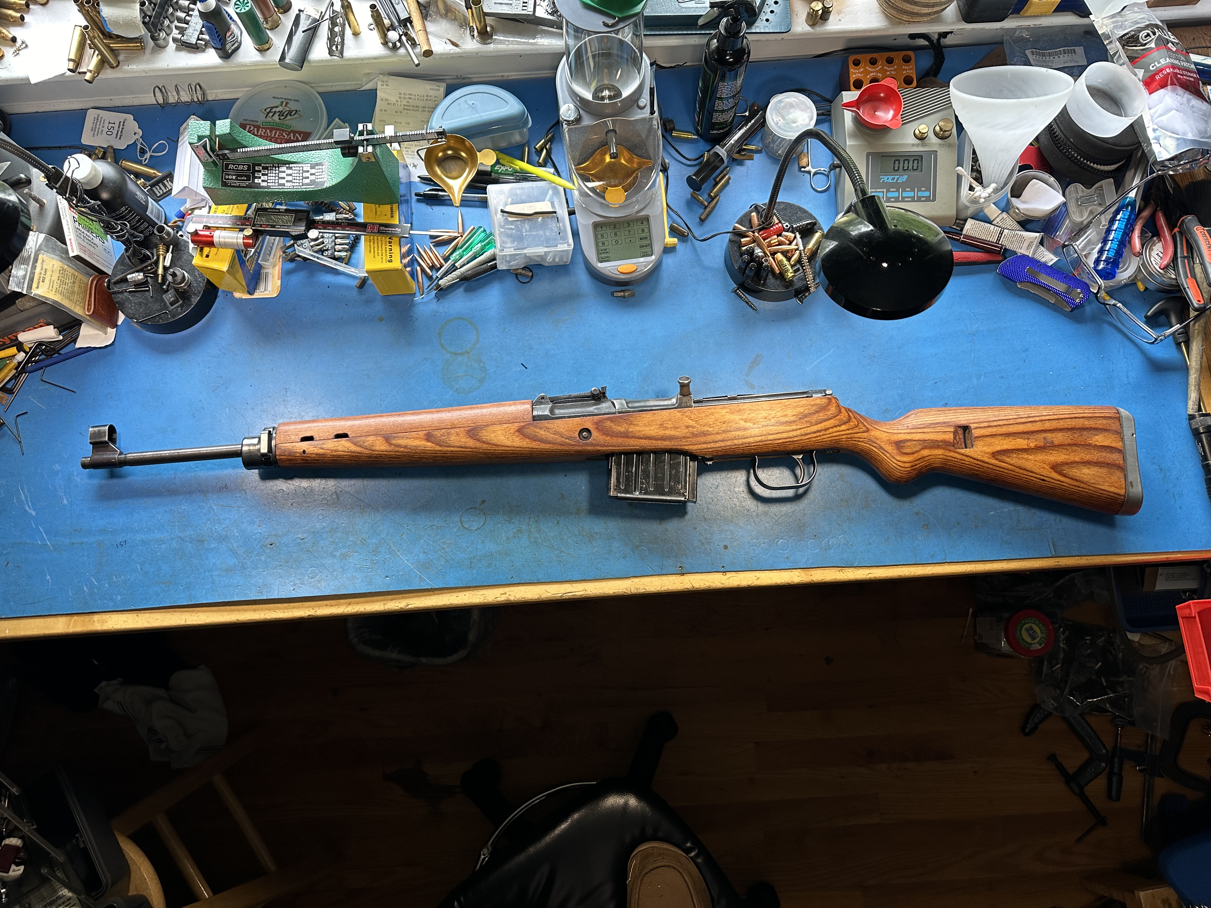

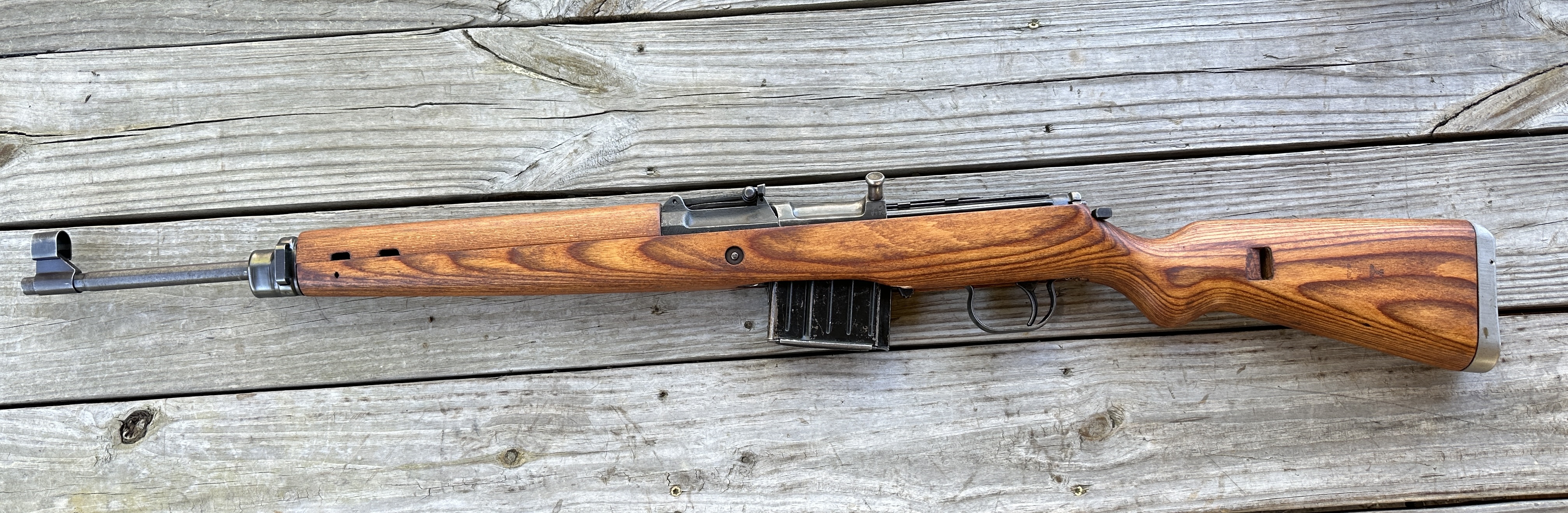

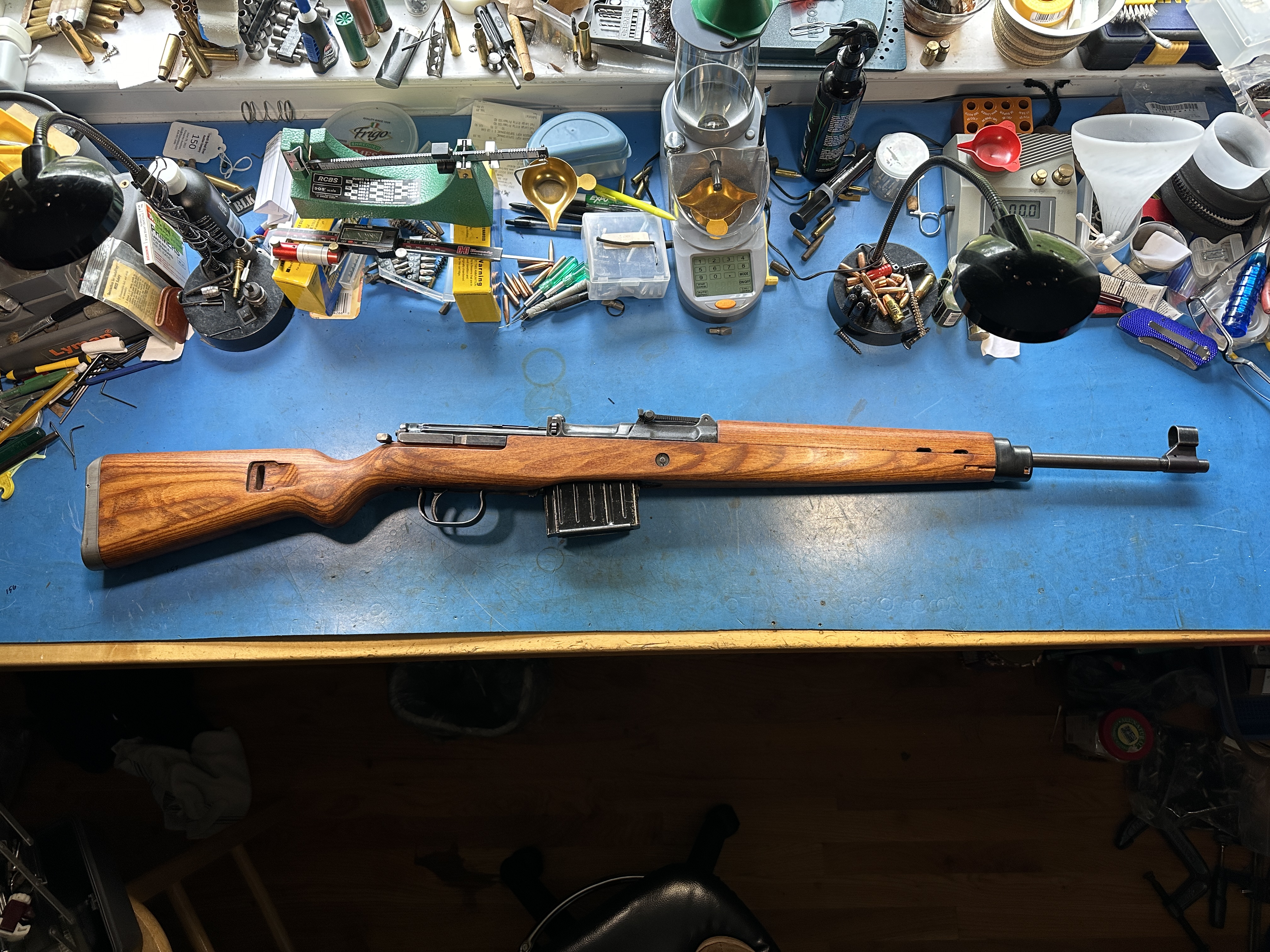

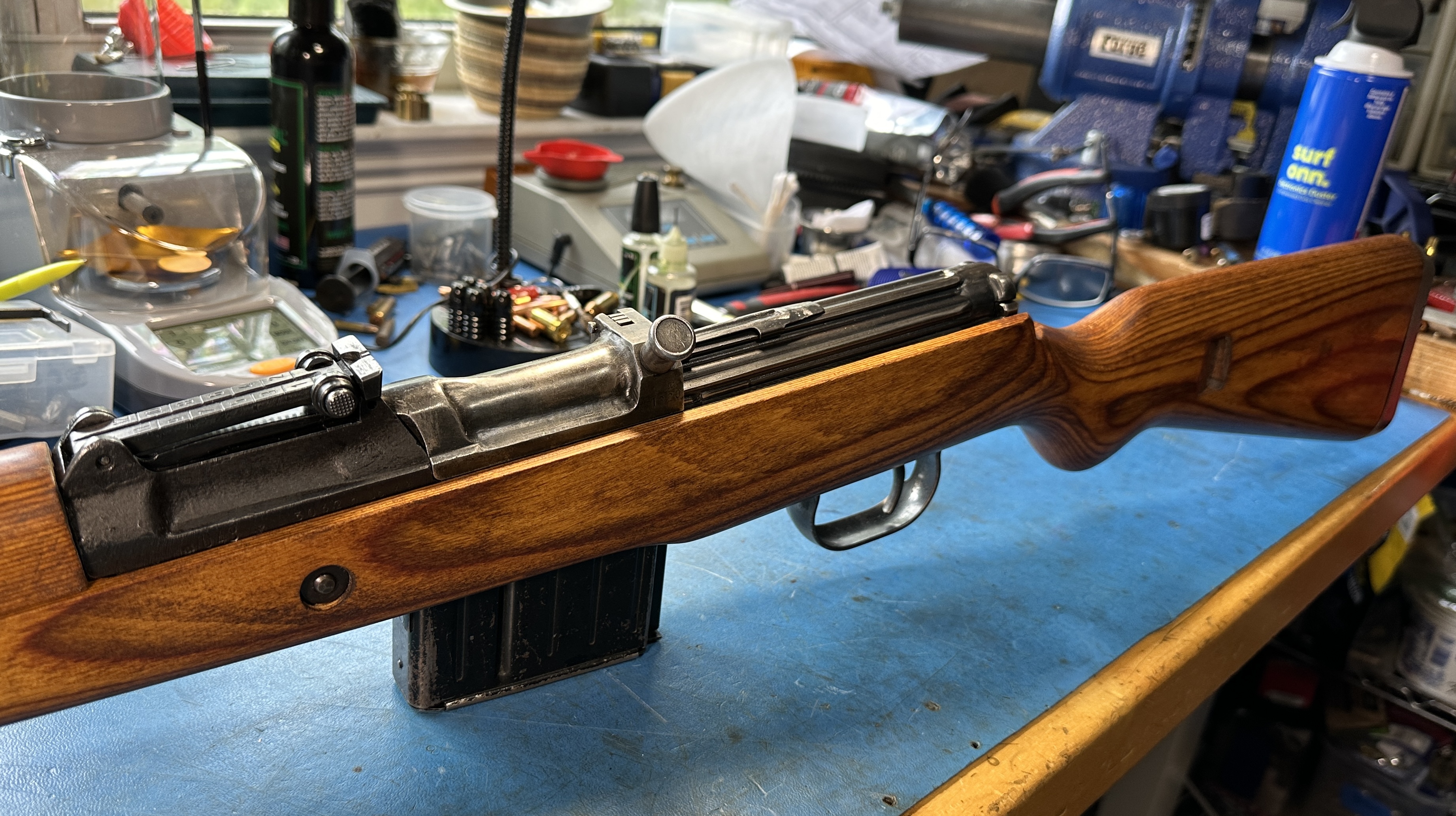

    G43 Fox reproduction stock arrived! Finally!
    The wait time is quite long but it was worth it.
    The pictures aren’t great being taken on my junky work table but you can see the stock looks great.

    That stock looks just about perfect, spot on.

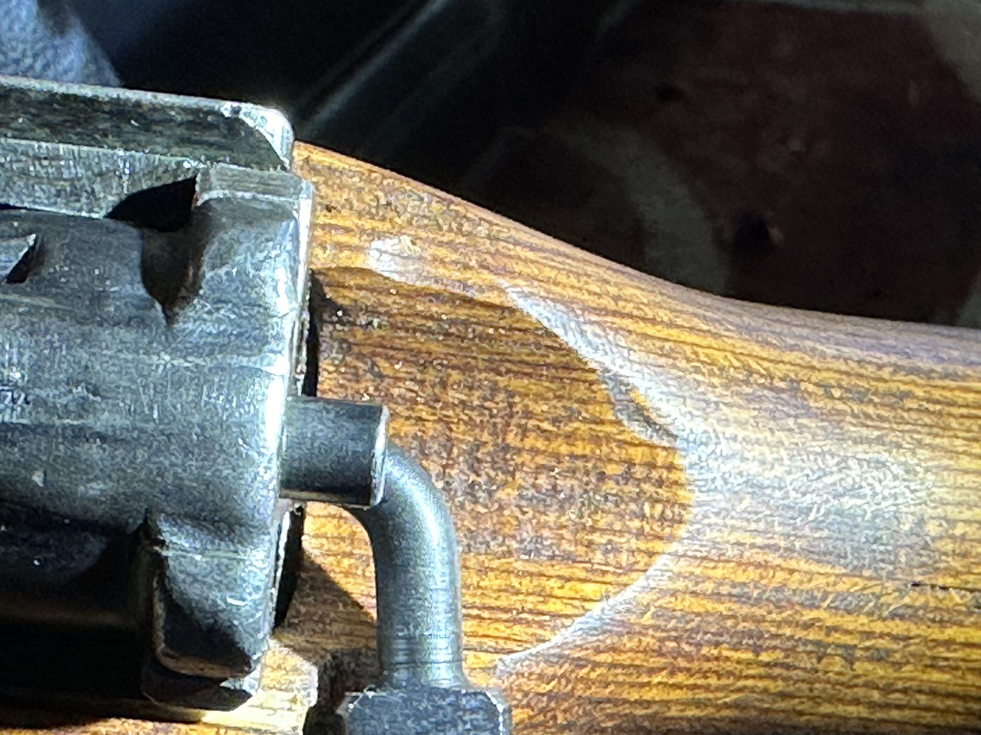

    I have one question about fitment. There is a small gap at rear of receiver between it and the wood, maybe 1/8”.
    The action fits perfectly down onto the recoil lug bolt up front. The action screws are snugged up tight. Will that gap cause any problems or will the recoil lug be able to handle recoil energy just fine? I suppose I could slip a small wood shim down in between stock and rear of reciever.But if it isn’t a worry I will let it be.

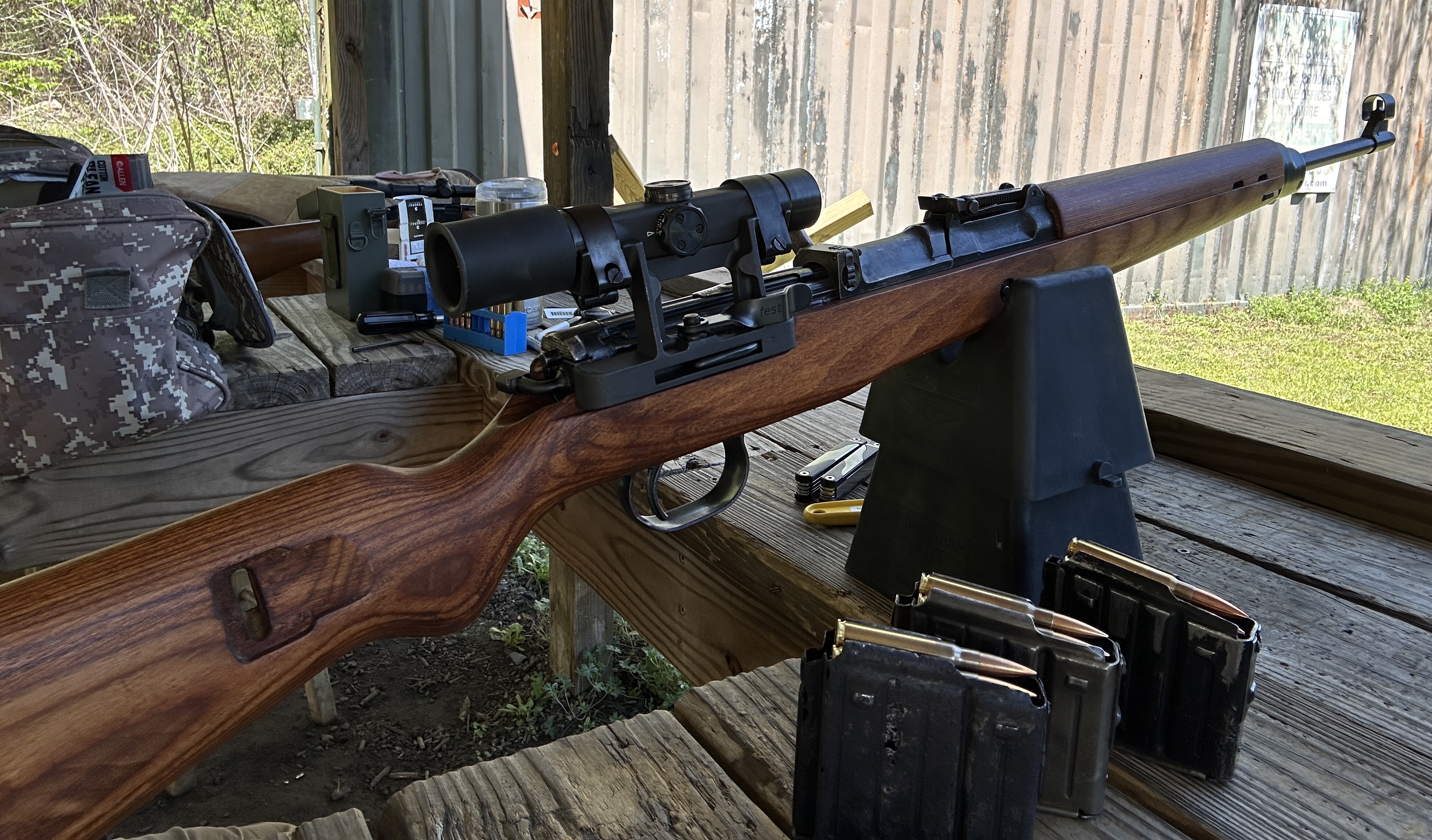

    A little better photos at the range.

    You want the recoil lug in the inletting to do all the work. A gap is GOOD behind the action, preventing cracks/chips in that location. Too much gap is better than contact.

    After my shooting session my concerns were gone. My observation showed the recoil lug did a fine job. Little if any rearward movement of the lug in its recessed hole.
    And the rear gap remains consistent.
