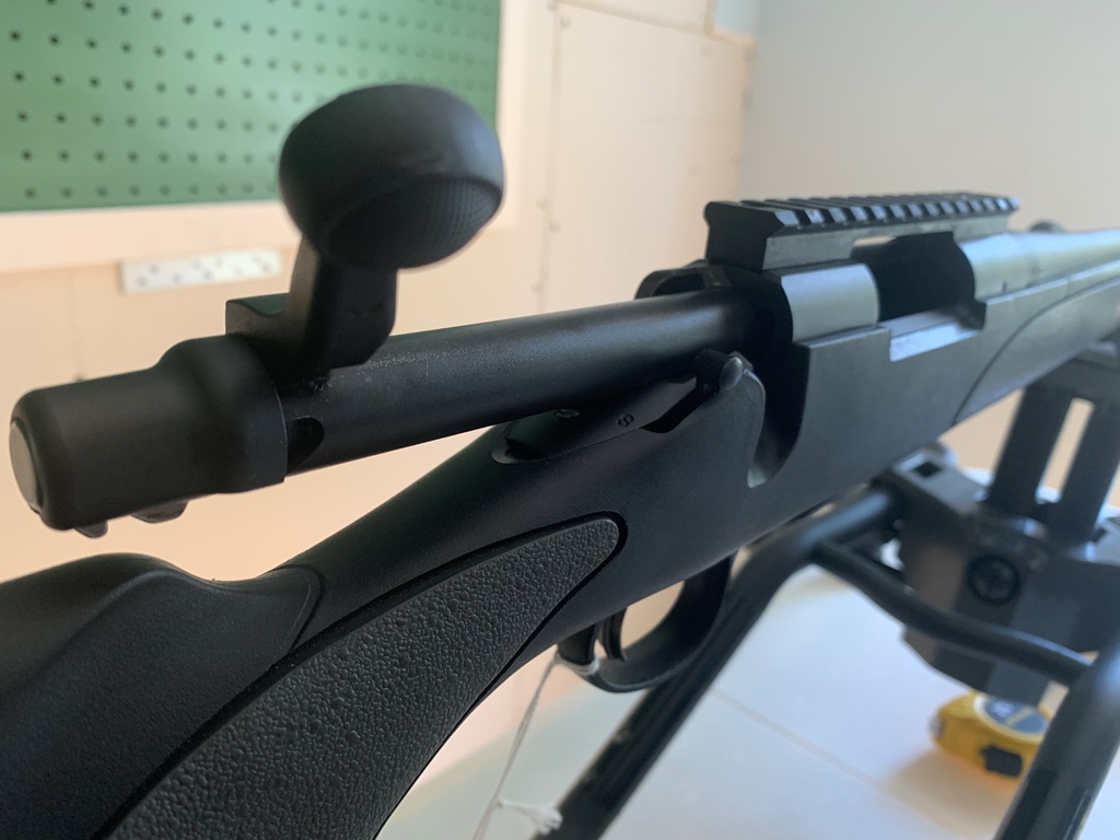

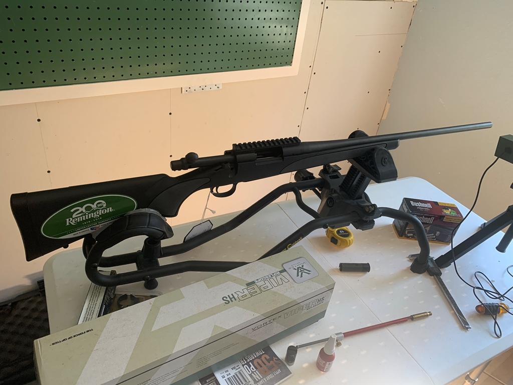

    Gents, I can't do anything but laugh. I was asked if I would be interested in purchasing a Remington SPS in 308Win. Well, I couldn't pass up the price. This rifle has obviously not been fired much. There is little to no wear anywhere, not even on the bolt. The rifle even has the factory advertisement sticker still on the stock. He told me he was just not happy with it and couldn't get it to shoot.

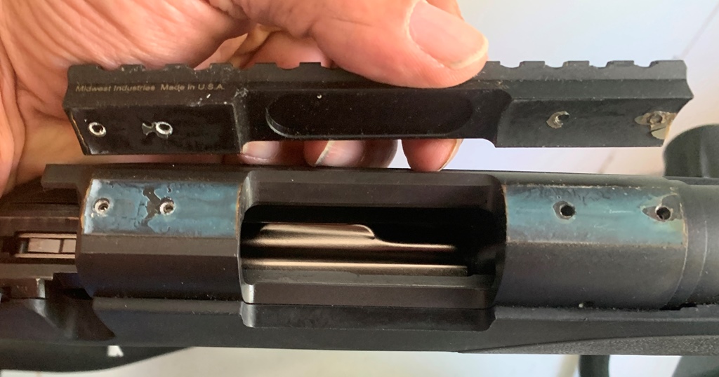

    I did come with a Midwest Industries Short Action Rail 6061 Aluminum Picatinny. Now, it's not that I don't trust others who mount things on rifles, well M-A-Y-B-E it really don't trust, I guess, but if there is a scope or a scope mount on a rifle, I always remove and remount, just so I know its done right.
    WELL.... the minute it started to turn off the screws on this mount, I knew I was experiencing something... Some thine Not-So-Great... I've seen a lot, and while I have seen worse things, this kinda is up there in the 'NO REALLY?!, WTF" category.
    I don't think I have EVER seen so much BLUE Loctitie on a mount in my life. Was the person doing this string to bed the scope mount with Blue Loctitie. I just don't understand.
    Well, this is going to be fun to remove. LOL. It's a good thing I have practice. What is this obsession with Blue loctite in the firearm community on scope mounts? If thread locker needs to be on these parts, it should be 222 or 222MS. And just a dab goes a long way.

    Me too. I used to curse the bubba under my breath that mounted before me, until I had a good friend bring over his brand new Remington 783, still in its box, with a scope and rings he wanted me to mount. The mount came already installed from the factory. Screws were either Torx or hex, I don't remember, but the first one required way too much force to remove, and boy ole boy was there a lot of loctite in there. the whole thing was a cruddy mess. I gently heated the others and they came right out with no issues. Underneath the blocks was enough loctite to fill a swimming pool.
    I think purple 222 is all that is needed for small screws. Ive seen 242 in kits, and sold on some popular sites without differentiating except for the number.
    I'll confess, I've used it (242) on scope mounts when it was all I had and they have easily removed months later to change mounts. The key is to use the right amount. I put a small drop on the wood stick-end of cotton swab, and then touch it to the threads. If your drop runs, you have too much. wipe off and try again. Same amount of 222 does the trick as well. I put neon red tape around the bottle of 271 (or 263) just to be sure I never make that mistake!
