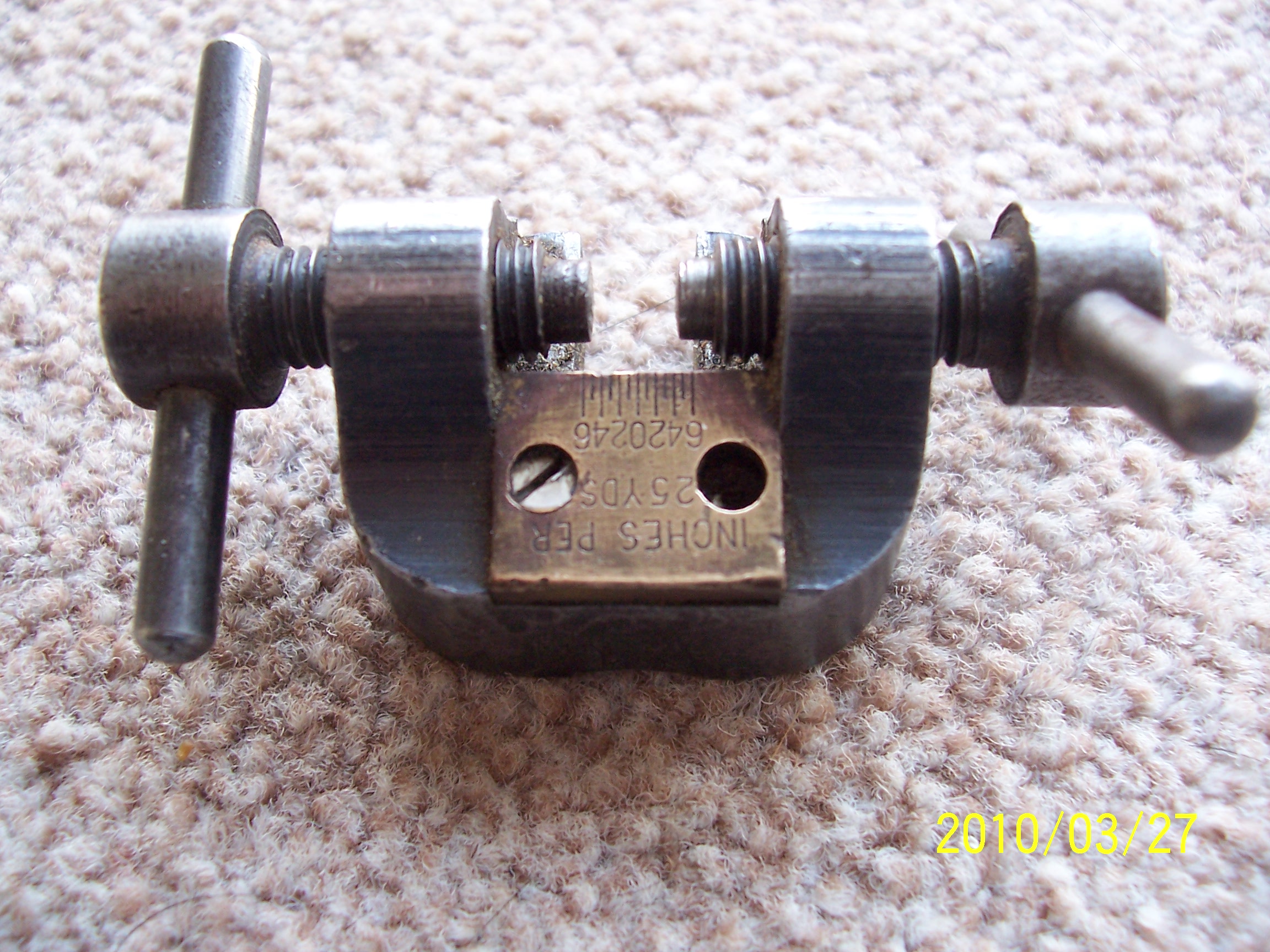

    Quote Originally Posted by Neuraleanus View Post
    What does that tool look like? I have the one for the sight with the slotted screw, but that will not work with this sight.
    You have had the answer, but so you can visualise it here is the tool used on the No1 MkIII (the No4 tool is similar)
