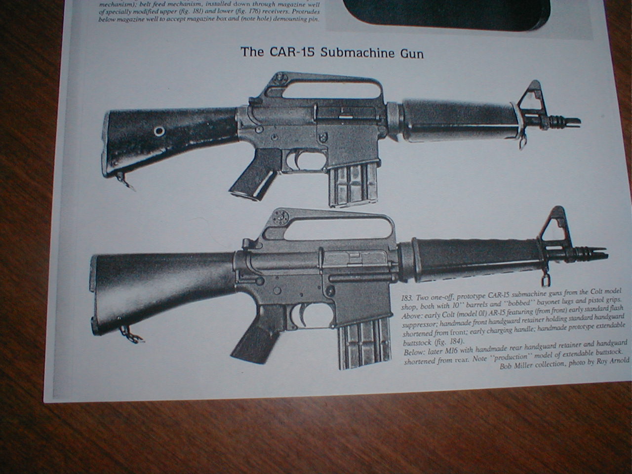

    XM177E1 & E2 and CAR-15
    Finding a magazine for the 22 WRM cartridge should not be that difficult as both Ruger and Marlin example s could be found -
    I did make a set of triangular hand guards years ago and liked them
    photo from "The Black Rifle "
