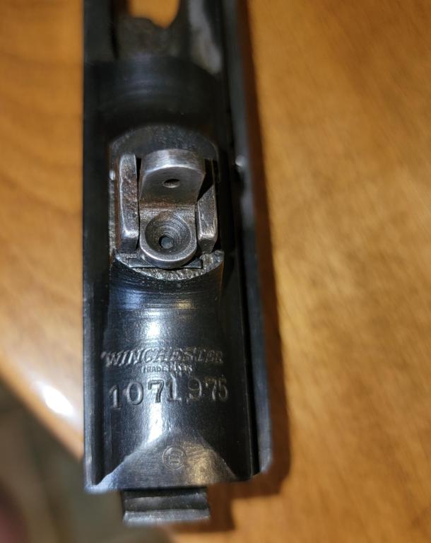

    I wanted to edit, it appears to be a TYPE II NPM trigger housing. I can't imagine Winchester getting parts from NPM so early in their run but it's strange that it's the right type but wrong maker?
    In any case, here are some pics!

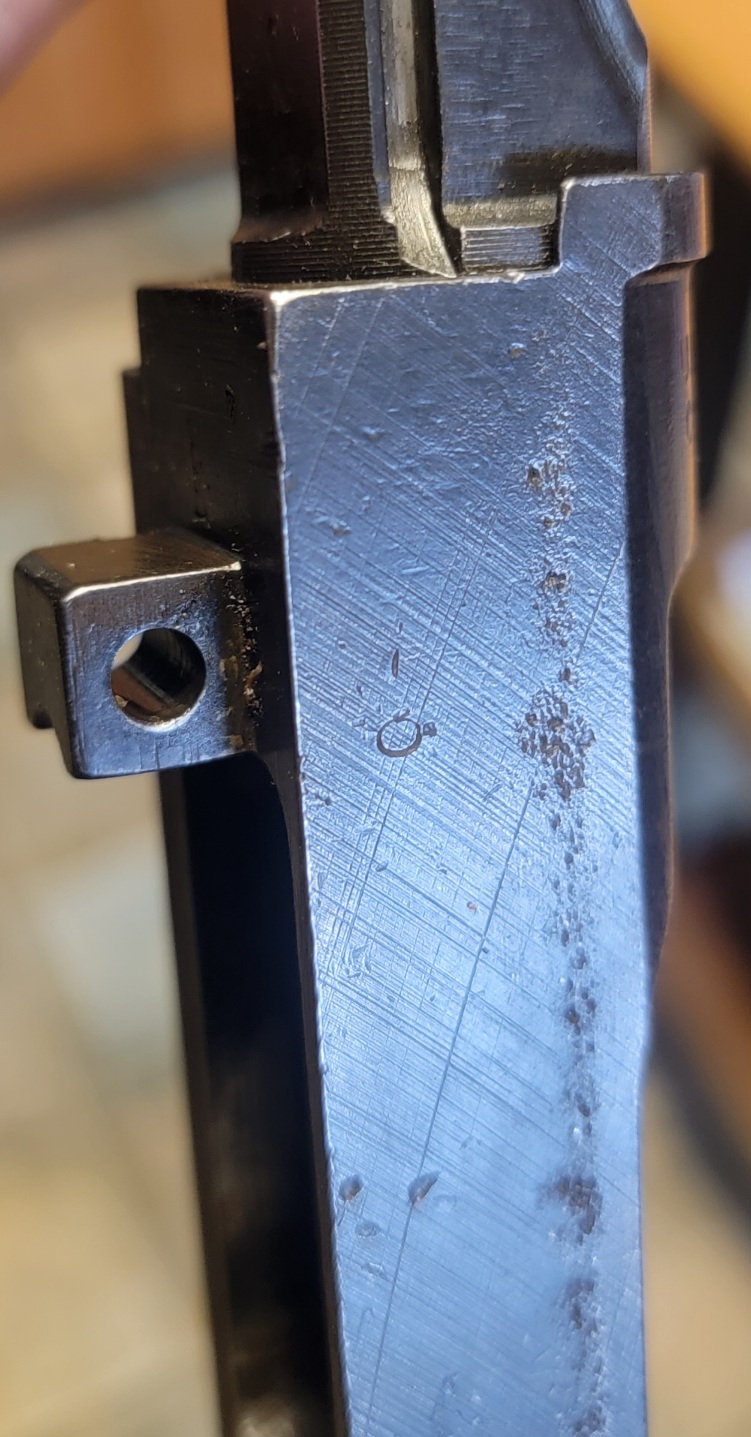

    Serial number was applied on 4-15-43.
    Seems I've seen that stamp you have on the rear tang, below the serial number before. I want to say on one of the Austrian Gendarmerie regions.
    Anyone recognize it?

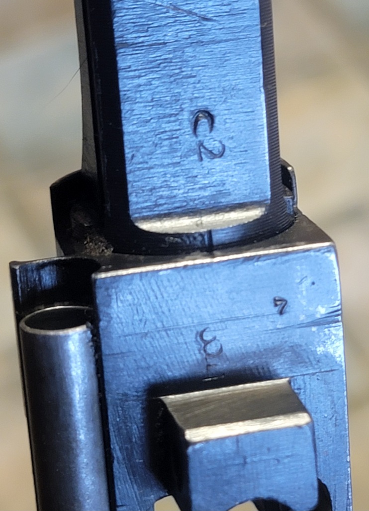

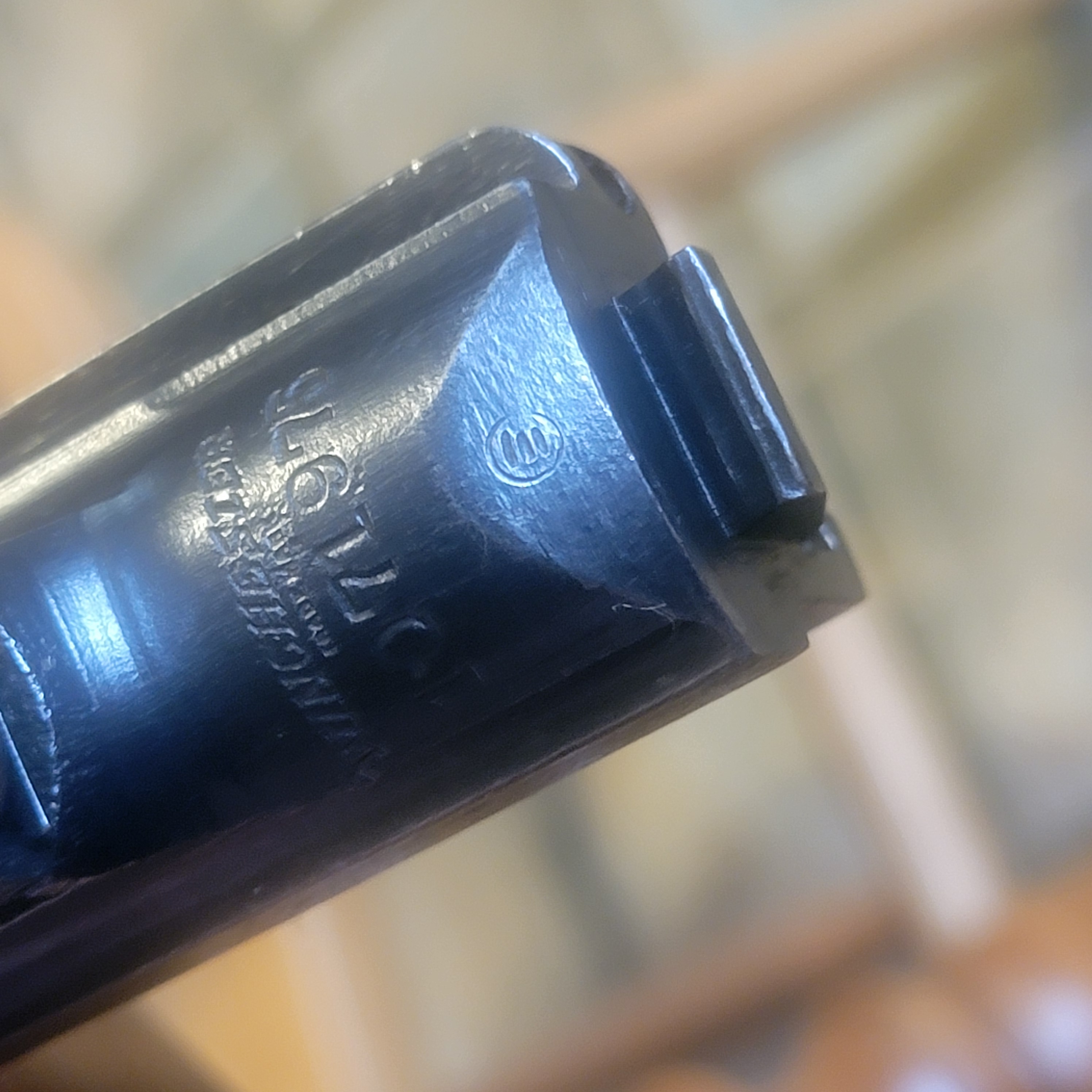

    Here is another picture of it. I didn't pay much attention to it before, at first glance I thought it was a sideways "W"!
    Maybe an "E"? This came from the Ethiopian re-imports by IO, Inc/ Royal Tiger so maybe, like the Austrians/Bavarians marked their receivers, the Ethiopians marked them like this?

    Can you spell out the Importers stamp, exactly as it's stamped. A picture of it may help also. Add its exact location.
    I may be on to something about the rear circled marking, but want to be sure first.
    BTW, Welcome to Milsurps

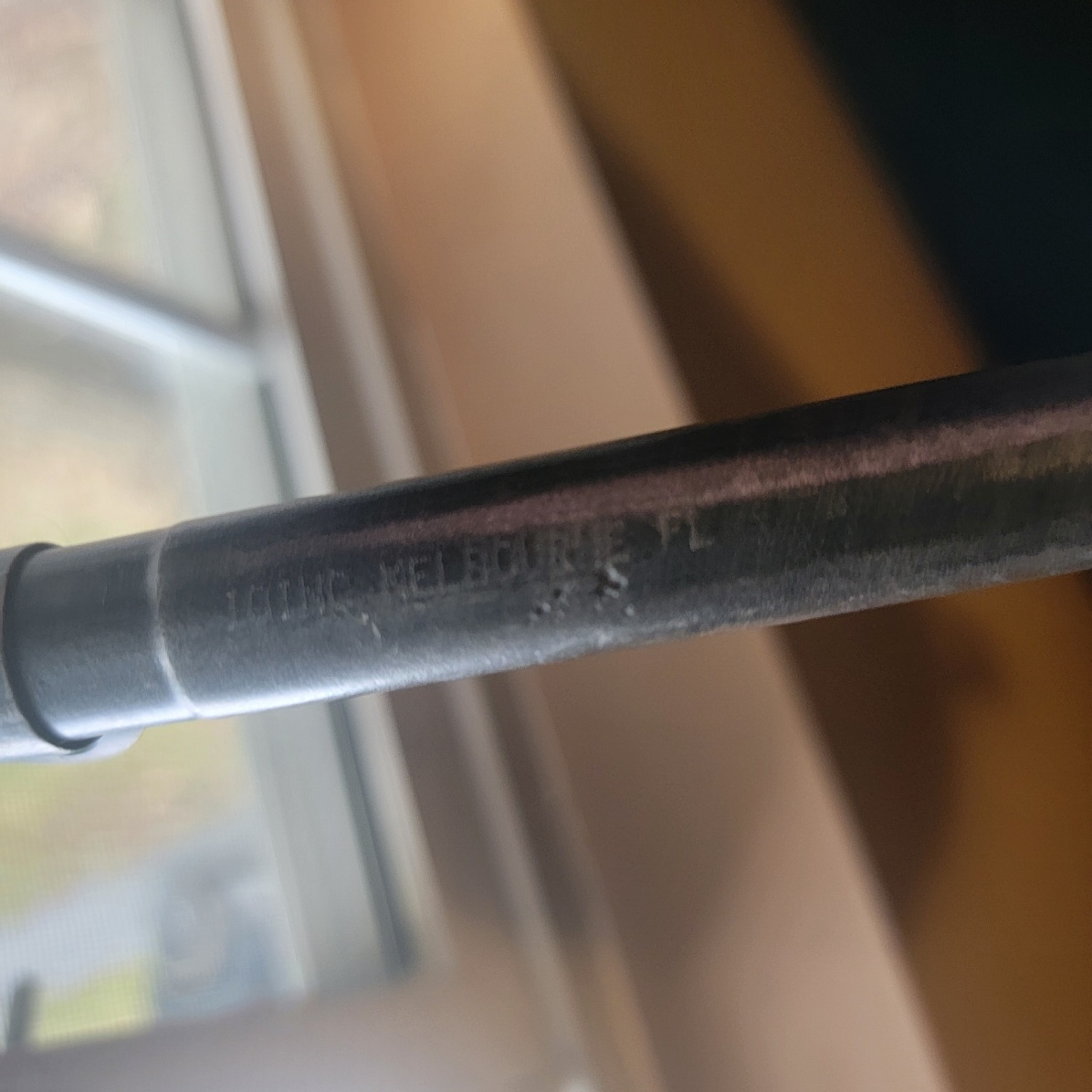

    Hello again! Importer stamp reads: "IOINC MELBOURNE, FL"
    Located under the barrel just rear of the front sight.
    Update: I pulled another RTI/IO, Inc Ethiopian return carbine, this time a 1944 Standard Products, and it has a slightly different import stamp, and no mark on the heel like the Winchester. The impost stamp on the Standard Products reads:
    LINE 1 Under barrel behind front sight: "IOINC MELB FL"
    LINE 2 Under barrel behind front sight: " M1 CARBINE .30 CAL. USAicon"

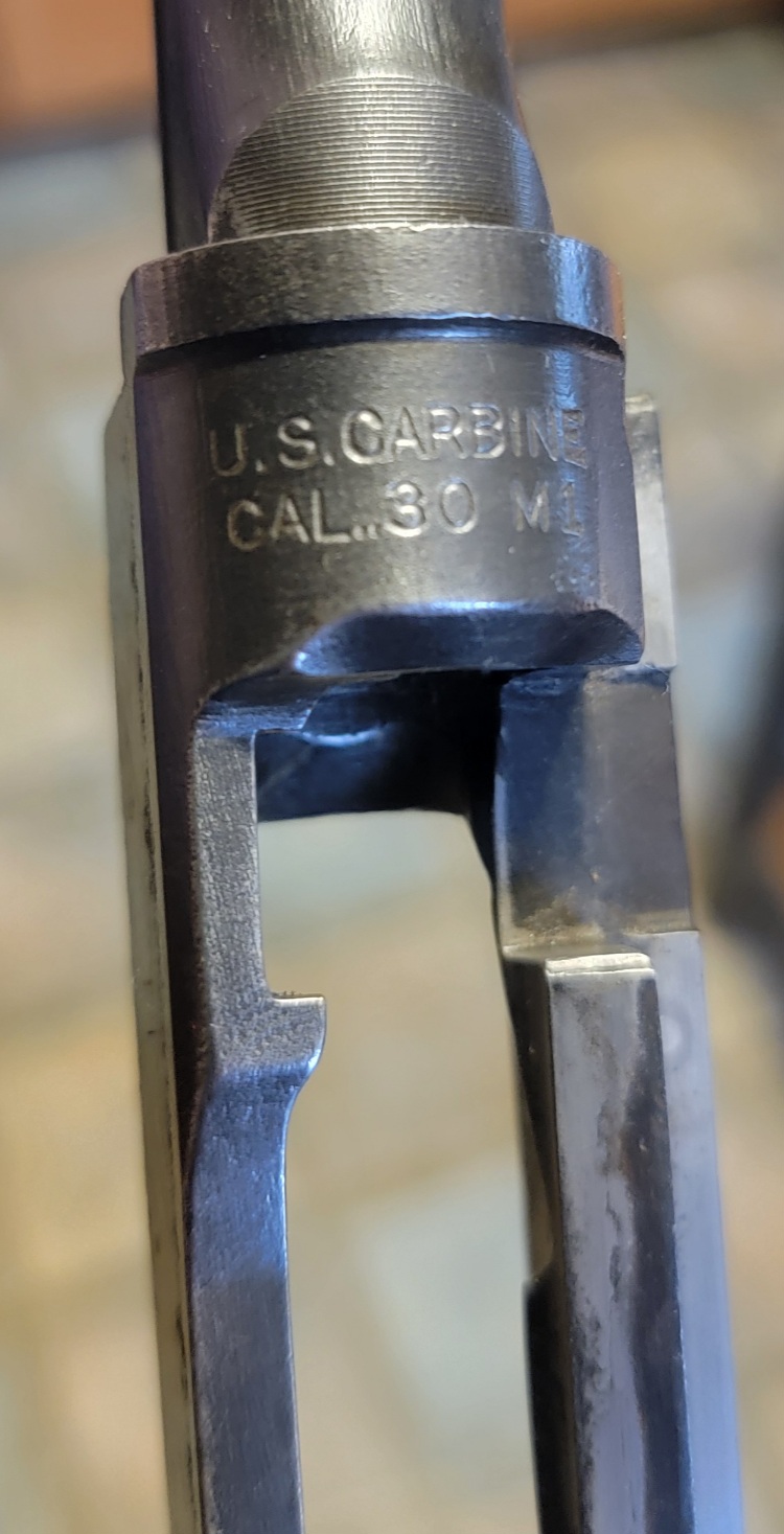

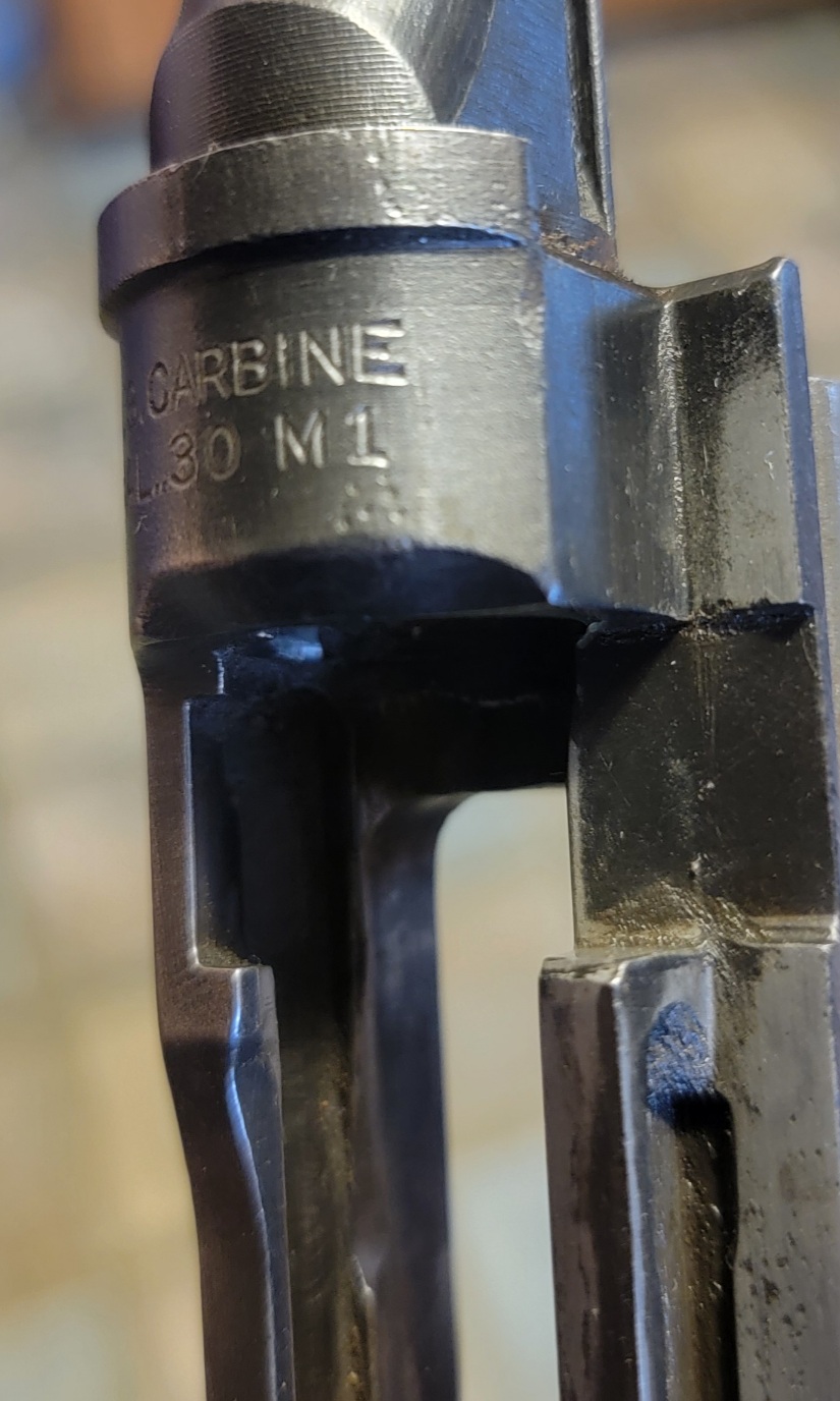

    Need to ask you to look and take a couple more pictures of your WRA.
    Pics needed are on the front of the receiver ring.
    We're looking for a possible added letter stamp or something that appears as such, maybe a partial stamp out of the normal.
    Take a couple pictures to the left side and right side of the below stamp:
    U.S. CARBINE
    CAL. .30 M1icon
    Note the * is the area we've found some of these letter/partial letter stamps on Carbines with Circled 3's. But look over both areas. Wouldn't hurt to look over the whole receiver. Not a fools errand, there's a reason behind this.

    @painter777 I don't see anything in the receiver ring itself but here are your pictures. There are some hyroglyphics below the wood line and on the bottom of the receiver and I tried to get those but I don't think they are what you're looking for...?
    I'm still cleaning out the nooks and cranies on the receiver so pardon the gunk. It looks like someone fired it while it was full of cosmolineicon. I can assure you it wasn't me. I rather like my face without shrapnel in it!

    TJ,
    Here's a link to the Carbine Collectors Club Forum that has a post that has been researching these 'Circled 3' stamps. You'll see on the last page #3 that I asked about the style of yours. Which I believe is the less commonly seen block style 3, like a reverse E.
    Many thoughts and theories so far as to why it's there.
    I'll also post this link over there.
    3 in Circle IP Receiver Marking ? - The Carbine Collector's Club - Page 1
