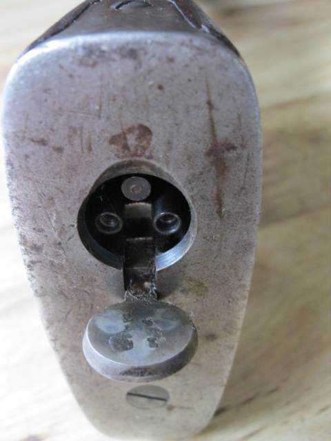

    I picked up a 1899 krag at an estate sale. my phone is broke so I can't post pictures. It has rifle sights on it and there is no sign of a date or cartouche. the stock has 3 holes in the butt trap for the cleaning rod. My question is are Kragicon carbine stocks supposed to have 2 or 3 holes for cleaning rod thanks

    To quote a well known member hereabout that is also on another forum...
    "butlersrangers 10-02-2015, 04:51
    Many military weapons (Mausers, SKS & Mosins) have cleaning or clearing rods that are too short to clean their barrel. In the Field, 'mess mates' could combine pieces to make an adequate Rod. In Barracks, there were longer Barracks Rods available.
    Not great logic, but, when the U.S. Kragicon went to the butt-trap and Sectional Rod, the Infantry Rifle was provided with three sections and the Cavalry Carbine got two sections (and most carbine stocks had three holes???)."

    Most Kragicon carbine stocks will have three-rod holes in the butt-trap. (This was so the machining operations were the same for rifle and carbine stocks).
    Some early thin 'long-wrist' model 1896 stocks only had two holes. These are very rare gun stocks.
    Supposedly, the carbine rod consisted of two sections and the sections were slightly heavier, than the three rifle rod-sections.
    The easiest way to identify a U.S. Krag carbine stock, versus a 'cut-down' rifle stock, is by looking at the forearm-tip area.
    The carbine stock will have a solid tip and the barrel-band will be retained by a flat band-spring, on the right-side of the stock-tip.
    A shortened rifle stock will have a filler-plug fitted into the stock tip. (This hides a stock lightning-channel, that was exposed by the cutting of the rifle forearm).
    The rifle barrel-band is clamped with a sling-swivel screw and retained by a cross-pin, through the stock forearm.

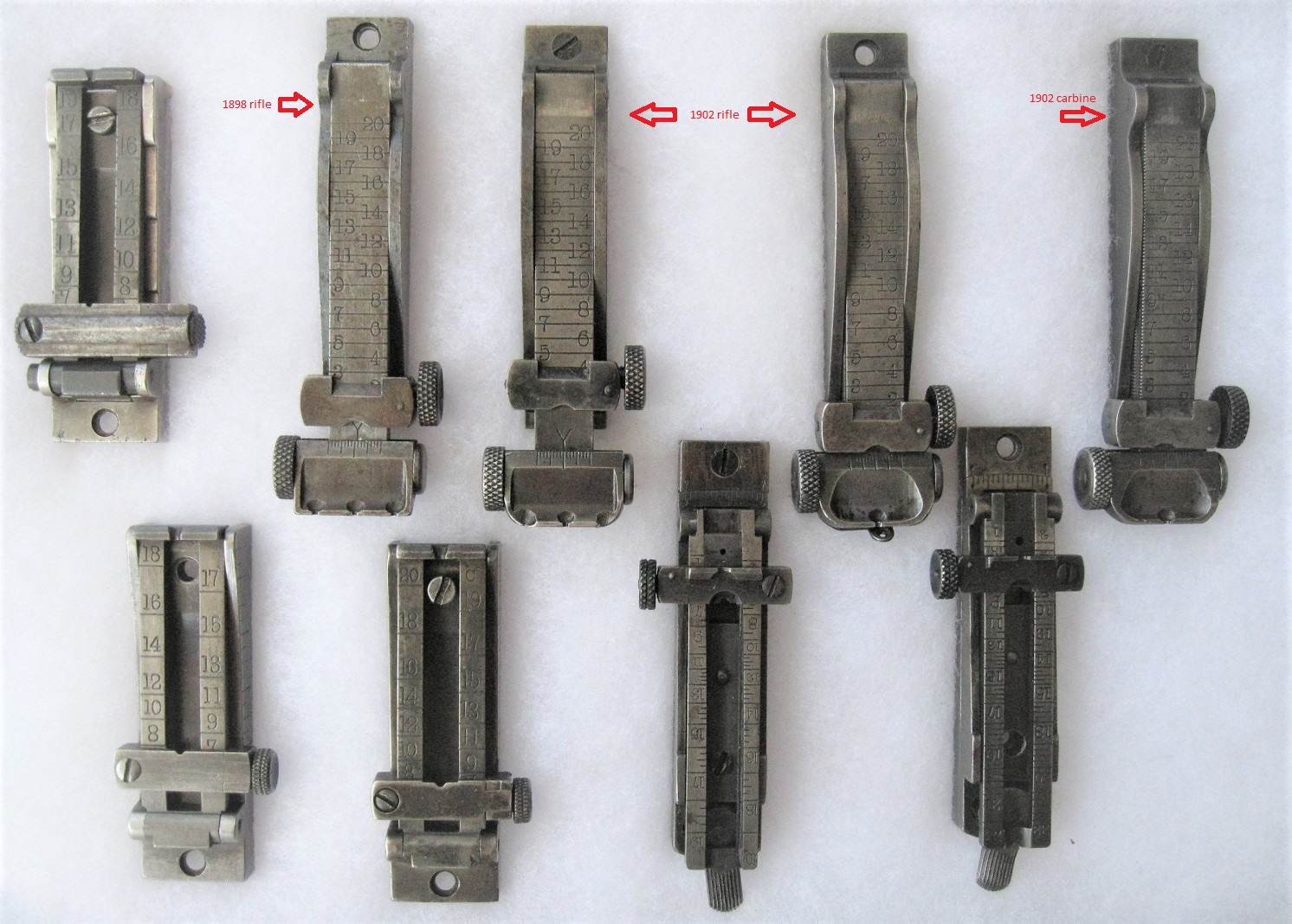

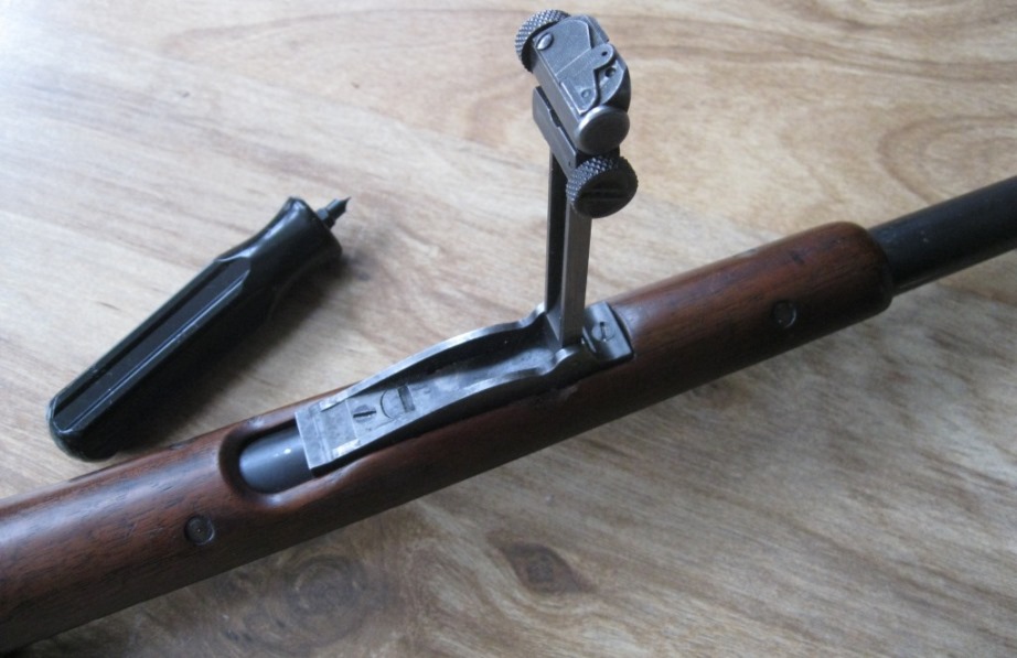

    just another question I have had 3 krag carbines and all three of them had Rifle rear sights on them Is it common to fine Kragicon carbines with rifles sight? Also were 1902 rear rifle sights marked with an R or were just the carbine sights marked with a C

    Carbine had a "C" and rifle was unmarked that way.

    My opinion is that Kragicon carbines often have Rifle Rear-Sights because a previous civilian owner switched the more valuable carbine sight with a cheaper (and similar) rifle sight in order to make more money.
    Only around 1,000 Krag model 1902 carbine sights were made.
    The 1902 carbine and rifle sights have identical 'tops'.
    The carbine base has a shorter 'ramp' than the rifle version and is marked with a "C", normally on the right-side, but a few real ones have the "C" on the left-side of the base.
    1902 sights are found both with the 'swing-up-peep' and without it, (on the rear of the eyepiece).
    The elevation 'locking-knobs' will often have been repaired with the later oddly slotted 1903 knob.
    (Note - The 1898 rifle and carbine sight-bases are similar to the 1902 bases and have a low ramp profile. These bases have an entirely different style of leaf spring.
    The 1898 sight bases were scrapped but got reused by surplus dealers in 'parts guns'. The 1898 bases are only correct with an 1898 'top' and its three-notch eyepiece).
