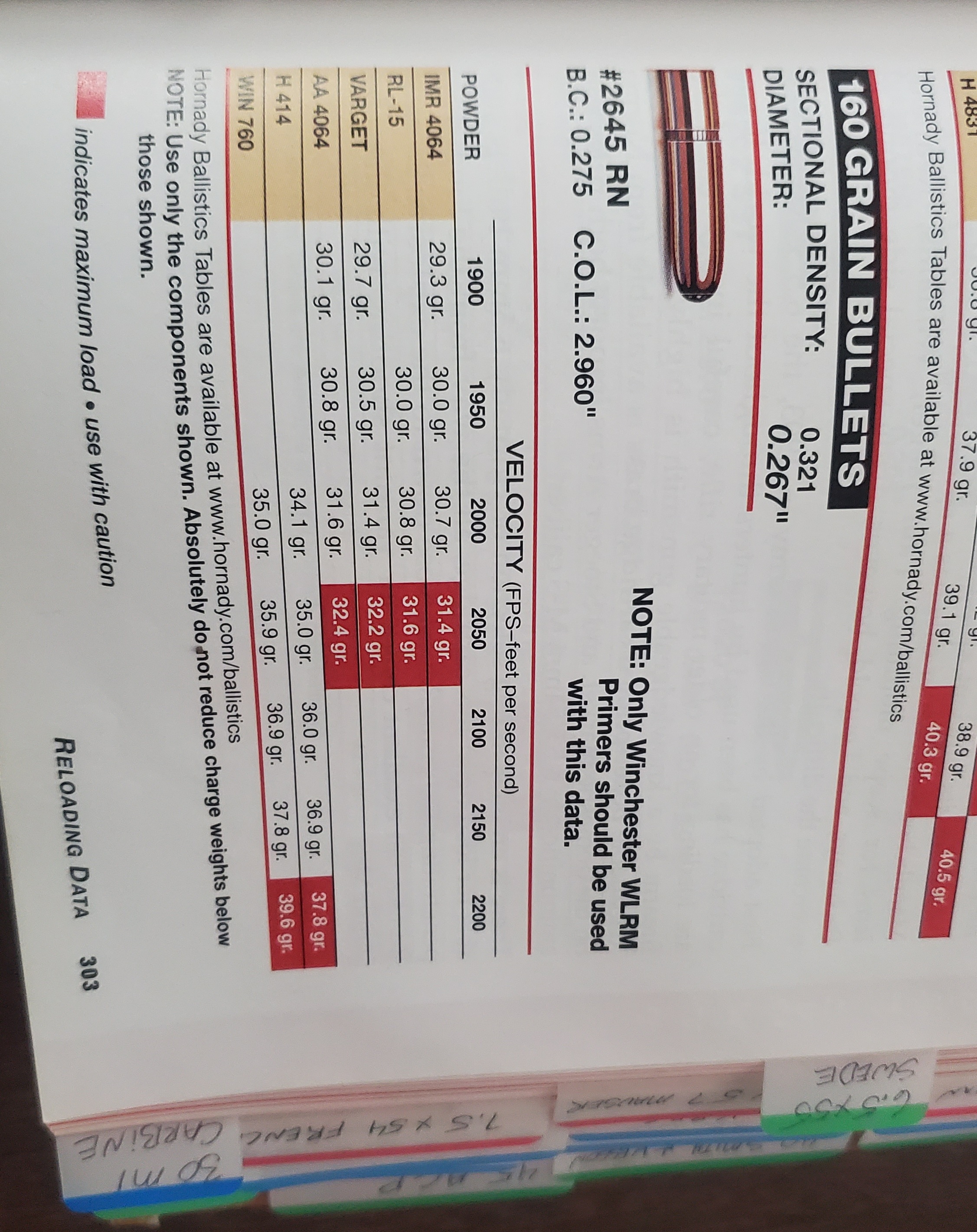

    Any one have any load data for the 6.5x52 using the 160gr Hornady bullet? I've found very little data for this cartridge!
    Thank you
    -matt

    Quote Originally Posted by Matt85 View Post
    This is directly from the Hornady 7th Edition handbook of cartridge reloading. This is for the .267 diameter bullet though.

    I have never used the Hornady bullets, just the military ones. .2675-.268”.
    With them I use 37,0 grs. Of W760, a Large Rifle Magnum primer and an AOL of 75,0 mm.
    Works great on a ‘91 long rifle with gain twist.

    I tried IMR 4064 and RL-15 with no luck, they produced very erratic velocities. I have some Varget and W760 but I'm having trouble with my sizing die so the project is briefly on hold.
    If anyone has a source of proper .266-.267 bullets Id be interested!
    -matt
