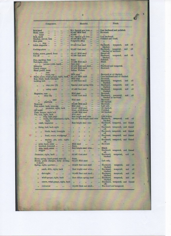

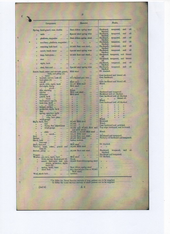

    Post Lithgow S.A.F Steel Specification Data Sheets and Inspection Criteria.
    Lithgowicon S.A.F Steel Specification Data Sheets.
    Pages 1to 5 are Steel Tender Instructions, pages 6 to 12 are 1912 spec's from SAF 1 to 14.with handwritten notations by J.K. Jensen, who revised the Spec's from 15 to 11.
    Spec Sheets 1 to 11 are the Spec's used from 1915 to 1950, showing the Steel Specification and the components made.
    O.F Spec. Sheets No. 34 to 110 are the modern ones and were used from 1950 to the present. These sheets can be cross referenced by checking against the SAF sheets, for example O.F No.64 A16 =SAF No.9
