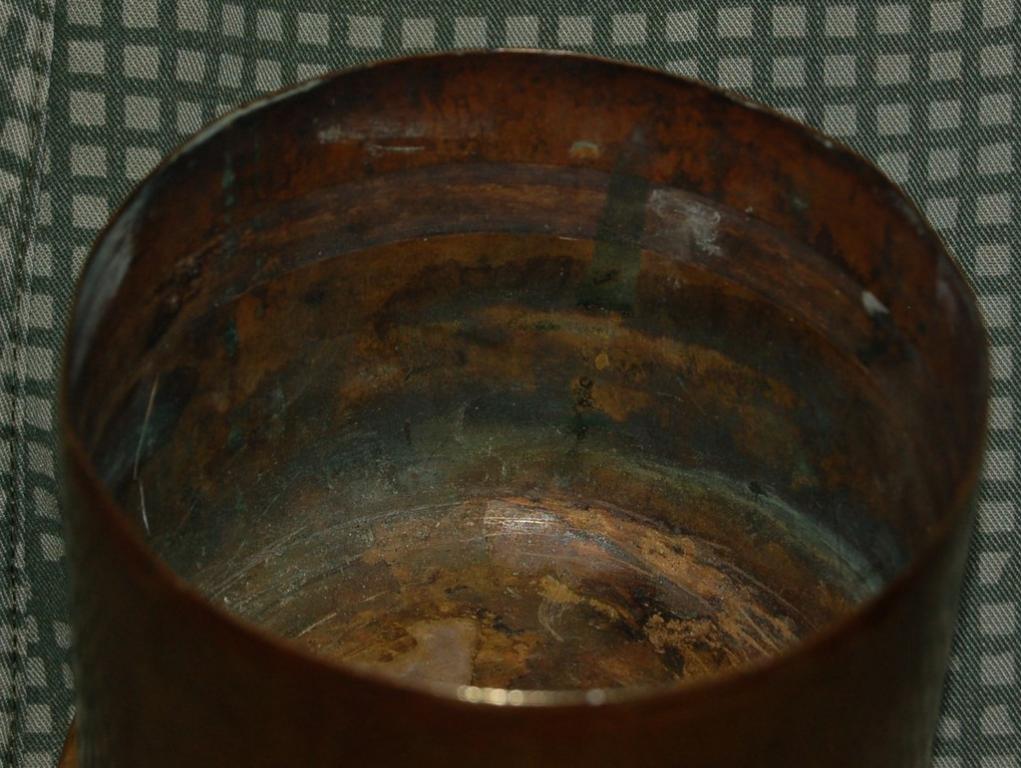

    Had some time to take a few photos today: The short fat one is the 10.5 cm, the tall skinny one is the 7.7 cm. You can see mill work on the inside of the 10.5 shell.
