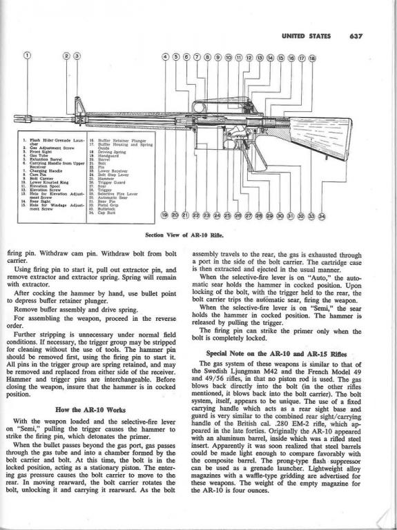

    While I was sure that I first saw the Armalite AR15 in a Popular Mechanics magazine around 1959 or 1960. I am still sure I did, but I also was such a gun fanatic that when I was 8-10 years old, I asked for gun books and magazines. Here is two pages on Armalite from my 1960 Small Arms of the World. It shows the top "trigger" charging handle prototype. It also lists the weight as 6.0 pounds with a 20 round magazine. probably the slimmer stock and thinner diameter barrel.
