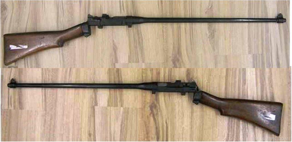

    About a year ago I saw a forlorn Long Branch advertised on Gunbroker. No one wanted this bare bones skeleton. Just looking at it made me sad -- this was once a beautiful warrior that had been sporterized, her snout snipped by 2 inches, then scavenged by vultures.
    It was literally just a lock, butt stock, and barrel; nothing else; her pockets picked over and plucked clean down to her bare bones. But the price was cheap -- only $37 USD plus shipping. I don't normally buy cheap, but she was a rare Sniper heading fast to the dump heap for parts unless someone interceded to break the chain of parting-out. And the Scope serial number was still legible on the Butt, along with the evidence of screws where the cheek rest was once mounted.
    What would you do with this poor soul? Do I restore her or just use the parts?

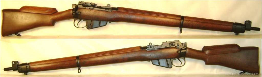

    Here are the pics Brian sent me this weekend:

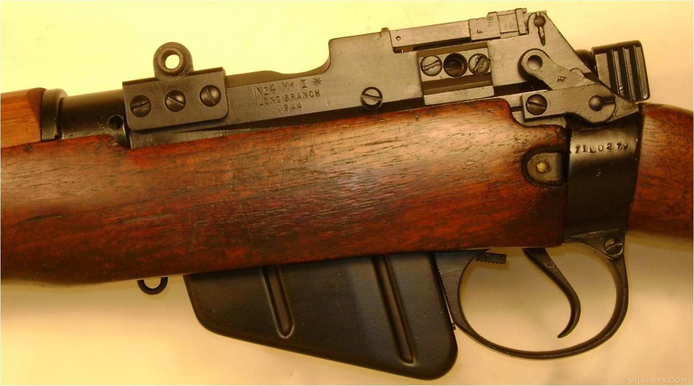

    You can imagine my state of awe. Wow! Brian found all the old parts, replaced the barrel, tuned the trigger, phosphated everything, found some beautiful walnut stock, reached out to Roger Payneicon for the right scope pad and walnut cheek rest, received the right hand guards from BigDuke6, and SentryDuty donated a Sling Swivel (forthcoming) and brought everything up to MoD post war FTR standards. It's a work of art. It's a true global effort, sourcing from the UKicon and Canadaicon to complete the project.

    I appreciate the compliments. Geoff gets credit for the handguards along with the others involved. It's not perfect but damned close! I found traces of Suncorite 259 left on the hulk so it got restored as it was in MoD service before "Bubba" got hold of it.
    Nice job.
    I was thinking that it was awesome how you captured the (typical of Long Branch) torn up screw heads on the rear pad...then I realized that they were original
  17. #9
    Apr 2008
    Today @ 02:26 PM
    Edgefield, SC USA
    4,057
    06-01-2024
    05:44 PM
    I was waiting for that L.E.! In retrospect, I probably should have changed them but decided to dress them as well as possible and not put the heat to it since it was secure and collimated perfectly with the new front pad. A little reminder of what Bubba can do with an ill fitting screwdriver! I never understood the desire to tighten screws that are soldered in tight.
