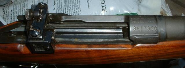

    Sportered SC 03A3, barrel dated 2/42?
    A few weeks ago I posted about a SC 03A3 that I have and was planning on converting to a 03A4gery, but had found that the reverse dovetail had been ground off. Readers offered some suggestions for restoring the reverse dovetail, but I decided getting a recovered drill rifle receiver might make more sense.
    I was poking around on the auctions and found this instead. It arrived, along with a second rifle that I glommed, at my FFL today.
    Description advised:
    Smith Corona Model 03A3 .30-06 caliber, 24" barrel, S/N 36179xx, barrel dated SC 2-42. Original parkerized finish on the receiver and barrel. A new sporting stock added. Condition: Excellent.
    I gave the rifle a quick once-over before it went into my FFL's safe for the obligatory 10-day "cooling off" period. It looks like the barrel is dated 2-42, which can't be. It also looked like it might have 6 grooves. The bore and metal looked in great shape.
    Also, most importantly, it still has the reverse dovetail intact

    Nope, not a 2-42 barrel, a poorly-stamped 12-42 barrel as John Beardicon said on another forum.

    I brought my rifles home from the FFL today and looked them over.
    The SC03A3 is in great condition for a sporter...and it definitely is a 6 groove.
    The metal is in great shape and the sporter stock is pretty nice too.
    The barrel has an ever so faint "1" in front of the 2 42 on the SC barrel
