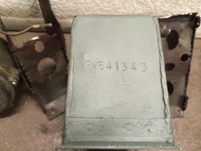

    Here are some pictures of some sheet metal parts that I have had rebuilt. The first picture is of the indicators. My ferret came with the typical later militia modification using US lights "scabbed" on to original light towers. I have chosen to go back to the light tower indicators and rebuilt the originals.
    I took great pains to keep the section of plate that had the FV number on it :salute:

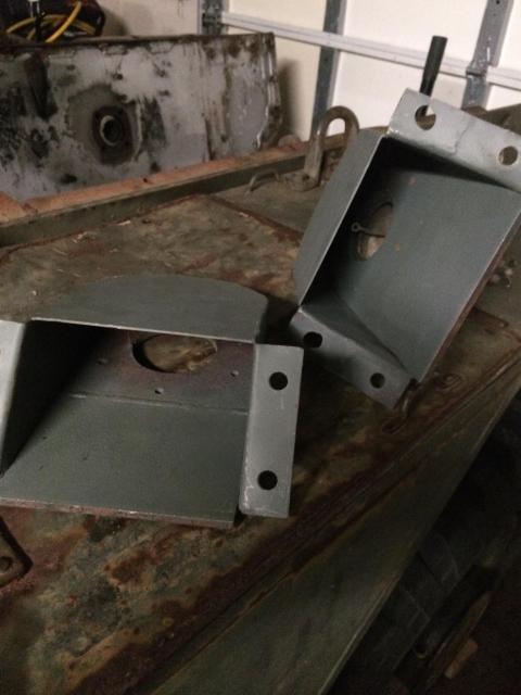

    The next picture is of rebuilt antenna bases. These had been cut up to fit a later US style antenna base, but as I'm restoring to a late 60's Larkspur era, I restored them to fit the correct type of Larkspur mounts ( You can source NOS Larkspur bases from Tim Vibert in Australiaicon).
