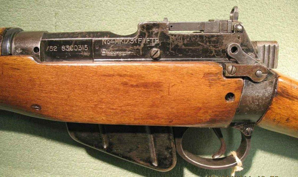

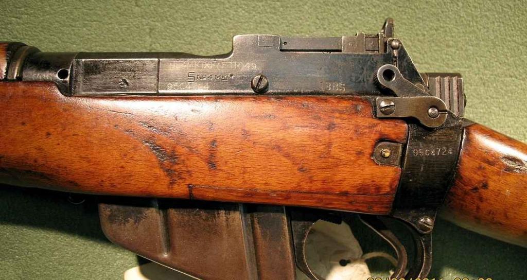

    Here are two No4 Mk1* that have been through FTR rebuild; they're both Savages, but essentially a Long Branch would turn out the same.
    You see they both have beech furniture, suncorite black paint finish, Fazakerly Mk1 rear sights (see the F or code on the slider). One has a Savage safety, the other a Fazakerley - although you can't see a difference without checking the code on the inside.
