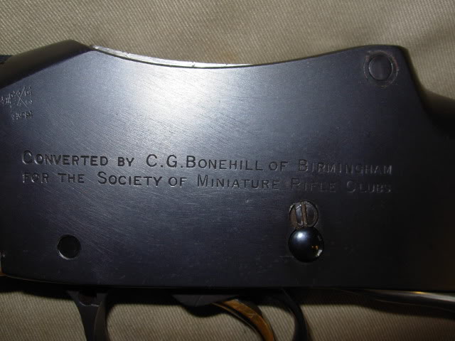

    In the attached files are pictures of my .22LR Parker Hale CMT-2 from around 1937.

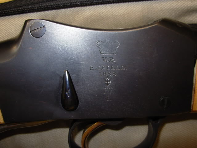

    The base action and stock are from an Artillery Carbine A.C. 1 (you can just see the C.1 on the side of the action in one of the pics) which has the VR crown etc. but most of the markings have been removed. It also has Victorian inspector marks on all the receiver parts and stock and may date from 1885.
    The left hand side of the receiver has been stamped by CG Bonehill as being made for the Society of Miniature Rifle Clubs (again you can just see it in the photos). This has been partially erased. The SMRC was a Victorian society to improve rifle marksmanship and commissioned a number of rifles in .22LR in around 1900 to be made from what at the time were cheap surplus rifles and parts.

    On the right side of the receiver, covering the Crown, is a round holder that can hold 10 rounds. This is a useful device which has been properly fitted but I am unsure as to its provenance. It could be pre-war.

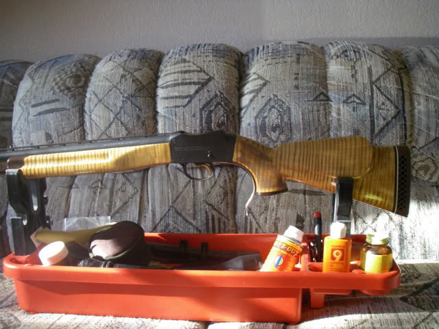

    i have a bonehill miniture converted martini , but its second conversion was to a 12ga trap gun
    the fellow who sold it to me sent this nice photo ---

    That is one mean looking conversion.
