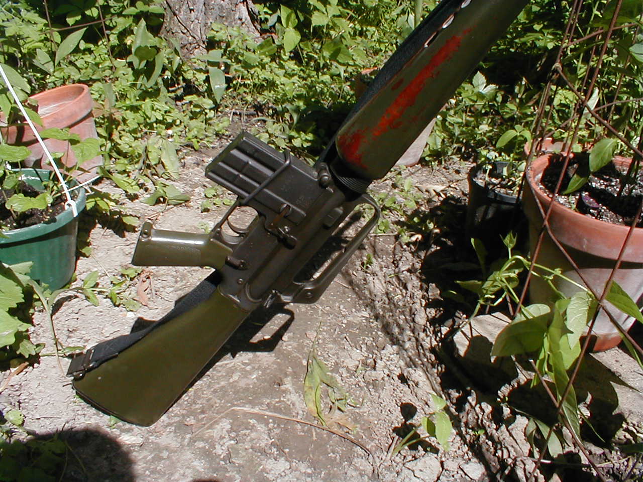

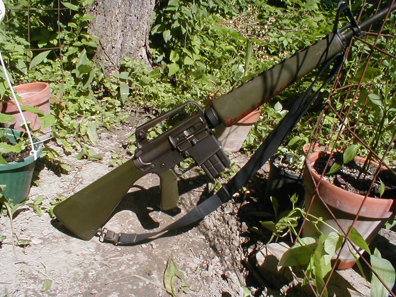

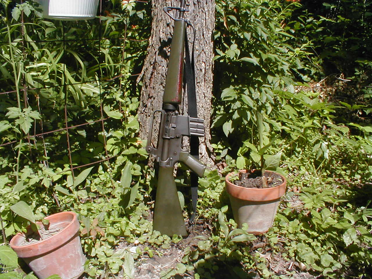

    original green color
    I had some original "green" color furniture and installed it on an early four digit Colt SP1 semi auto sporter- sort of a fake 601. Added an original triangular charging handle too and early bolt catch

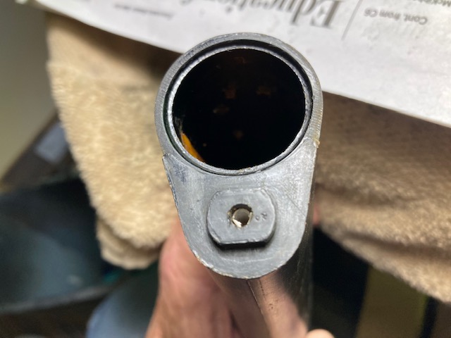

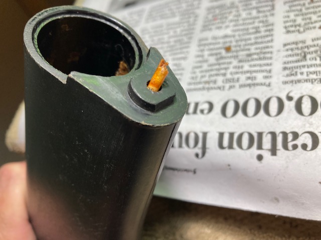

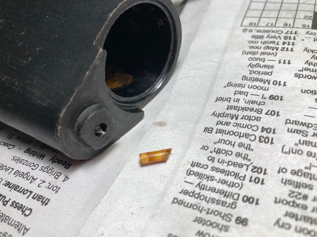

    The buttstock arrived this morning and looks very good. The sling swivel was removed and the stock lightly sanded with 180 and 220 W/D.
    The tab that inserts into the receiver has a hole with some sort of material that I assume was stuck in there for some reason and I'm confused as to what it is or the purpose.
    Photos attached are the best description...anyone also know what the purpose was for the hole??
    edit:
    Help...! The realization has struck me that I'm not sure where the detent spring for the takedown is supposed to go on this stock....is this the wrong stock for a 601?? Something doesn't seem to make sense.
    Dick

  10. #27
    Today @ 10:41 AM
    30,037
    06-01-2024
    11:45 AM
    Quote Originally Posted by Madcap View Post
    Goes off center. Don't sweat, you're fine.
  11. #28
    Legacy Member Madcap's Avatar
    Jan 2022
    Yesterday @ 02:50 PM
    Hill Country, TX USA
    177
    Dick
    06-01-2024
    01:45 PM
    Jim, do you mean the spring is inserted into that hole in the tab...? What's that thing I picked out of the hole?
    Thanks for your help.
  12. #29
    Today @ 10:41 AM
    30,037
    06-01-2024
    11:45 AM
    the spring
    No they go off center in a hole and are retained by the flat surface. Don't know what that center hole is. I had an early test model Colt, and the assembly wasn't any different than later models. Just no fence and markings are different. That projection keeps the butt from turning in the receiver.
  13. #30
    Jan 2022
    177
    Dick
    06-01-2024
    01:45 PM
    You must mean the hole offset in the end of receiver where the detent spring inserts, and protrudes out then just rides flush against the end of the stock...correct? I mistakenly thought there was a shallow hole on the later stocks that helped to index and hold that detent spring. I think I confused myself, but think I finally get it now.
    Thanks for your help once more - always appreciated.
