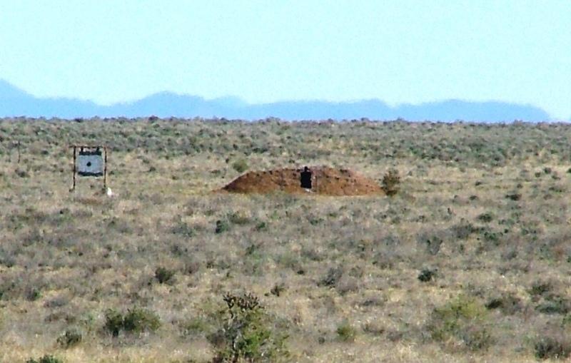

    I went to the range today,bright and sunny. 50 degrees F and 15 mph wind at my 7 o'clock.
    I had loaded up some M-80 Ball bullets to Britt spec's and gave it a go at the 800 yard target.
    The front screw is very sensitive to elevation. I put in what I thought would be about right and the bullet went 1,100 yards down range. After returning to the 500 yard setting I found I only had to go down one notch and put the point of the SUIT Sight onto the center of the man silhouette. Any more or less would go way over or under the target.

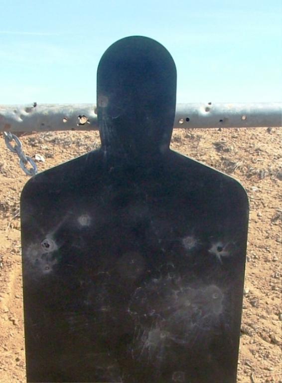

    The L1A1 has a brand new barrel but I have found that if I can hold 4 MOA that is about the best it can do. I fire 20 shots and got ten hits. Not match winning but good enough to prove that the SUIT Sight can hold is own at 800 yards.
    I may return and try my heavier match loads and see how well it shoots.
    The Rifle
    A telephoto view of the target on the right at 800 yards
    The hits on the target

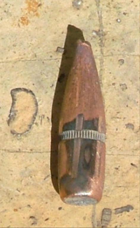

    One of the recovered bullets. Good rifling marks and a good seal around the bullet in the rifle's bore
