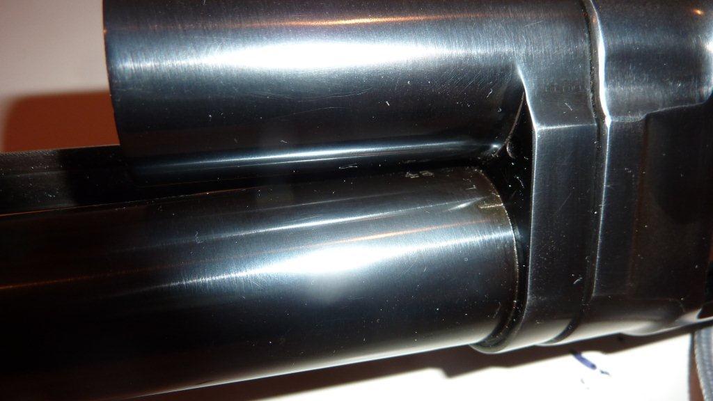

    I took a few additional pics that show the: the '48" barrel mark, with a witness mark along the barrel, as well as a another witness mark on the other side of the barrel along with another 'triangle' mark.
    Pic 1- "48" mark along with a witness strike, and what looks like an "L"
    Pic 2 - shows a witness strike, along with a triangle.

    Legacy Member Tom Doniphon's Avatar
    317
    06-27-2024
    10:32 AM
    The stock was cut for a sling swivel. That's an indication that it may have been a trench gun buttstock. The Military guns have inspector's and Ordnance marks on the left side of the buttstock. If there was one, it's probably been sanded away.
    I agree. Whoever did the refinish did a nice job.

    Thanks Tom... very helpful information. So looking at data/evidence it sounds like this is what might have happened:
    • Originally a M12 Trench gun- Serial number dates it to the last few 1000's trenches made.
    • After the war it was refinsihed in a commercial blue, stock swivel inlet filled, and perhaps had a '48' barrel installed.
    • At sometime (perhaps at time of refinsh) had the choke added
    I have just one last question- looking at the refinsh work I'm suspecting that Winchester might have done the work. If that was the case would Winchester mark a new long barrel with the WP stamp.. or would they mark it with a "P"?
    Thanks!
