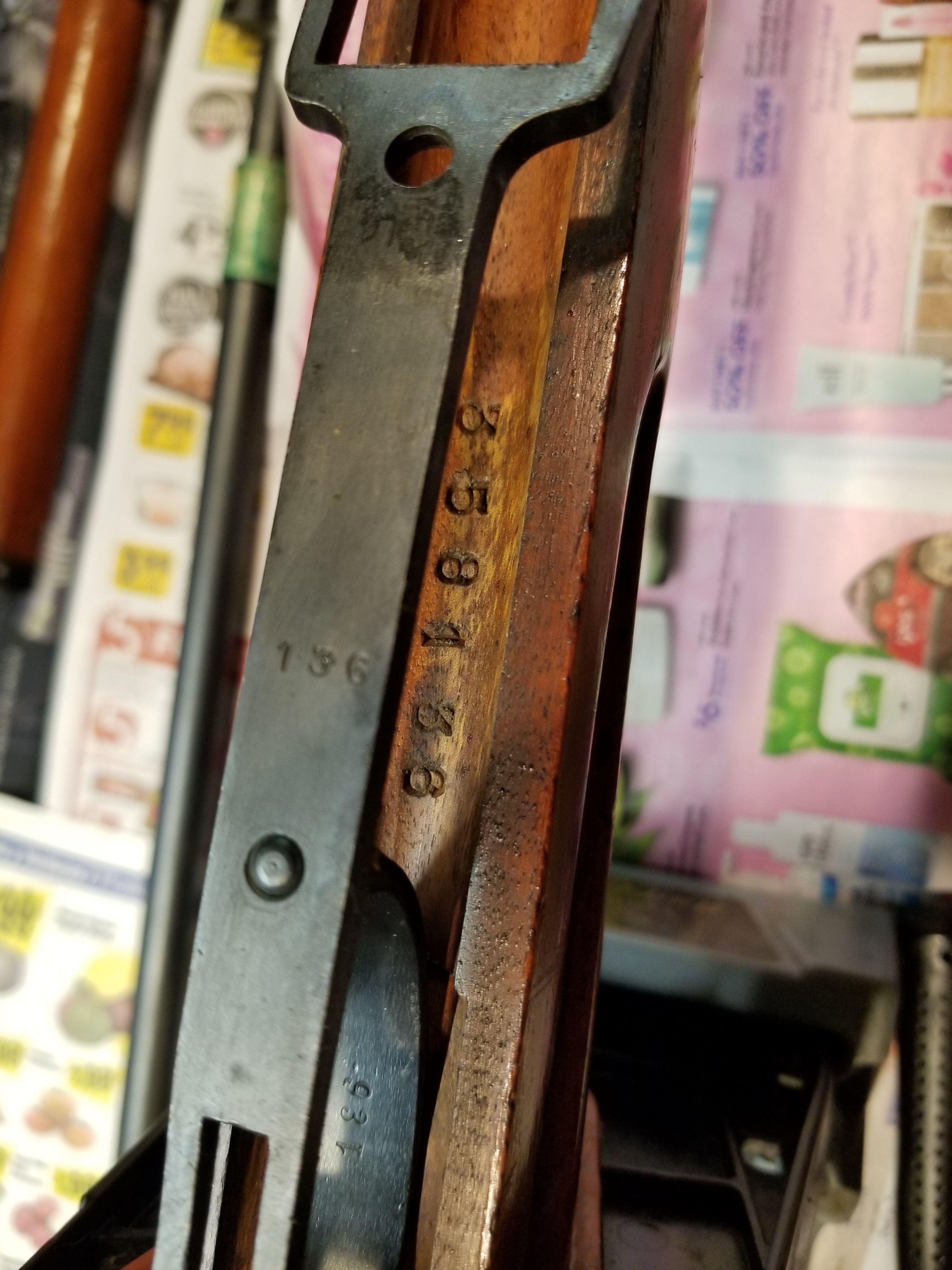

    I have finally had some time to disassemble, clean and service the K31 and G11 I picked up a couple of weeks ago. The G11 is truly beautiful and the Swissicon craftsmanship is off the charts for a rifle manufactured in 1912. This rifle also had the soldier tag under its buttstock plate (as did my K31). I believe this gun may have matching numbers (butt-plate, front BB, rear BB, magazine, trigger guard, trigger, bolt, stock, handguard, barrel and receiver). I noticed there was also a different 3-digit number on the sight and the sight slider. I have two questions:
    1. Are the numbers on the sight supposed to match the other numbers as on the K98kicon?

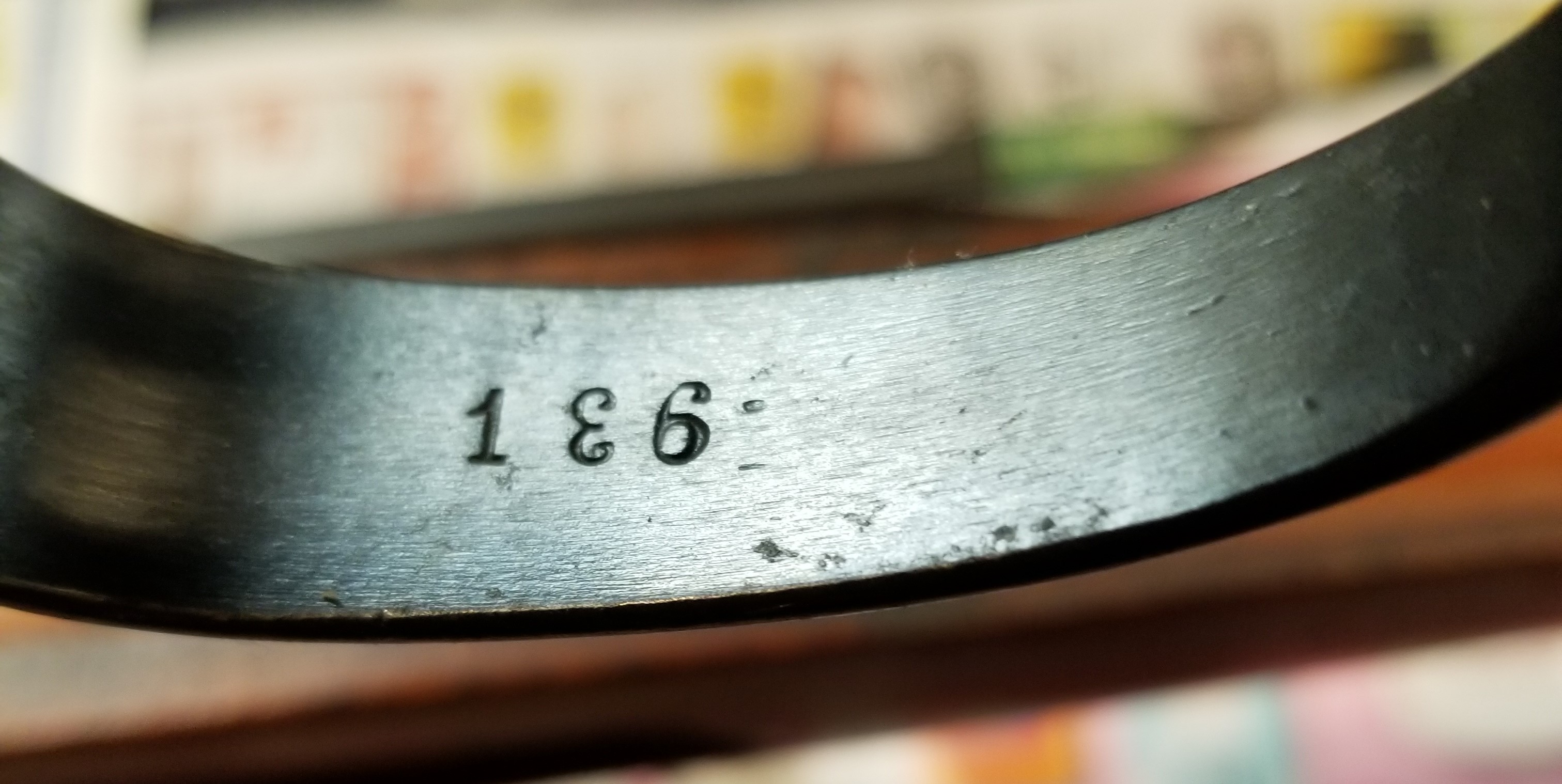

    2. One of the 3-digit serial numbers on the trigger guard has one number (the "3") stamped backwards. Any idea why or if this is normal?
    Thanks!

    Numbers should match but it isn't a big deal.
    As to the '3' digit stamp being backwards, likely just put it in backwards and either let it go or didn't realize it at the time.

    Numbers on rear sight are assembly numbers, not intended to match rifle serial.
