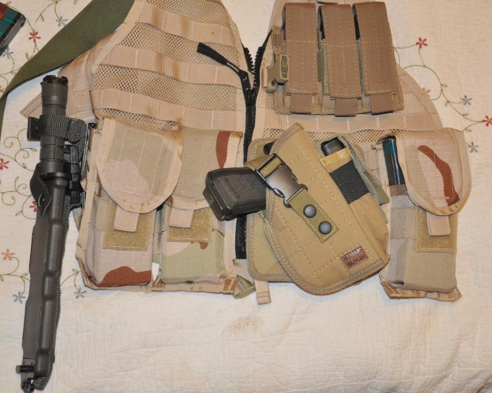

    Here's some pictures finally of my build and MOLLE FLC. Good camera, but horrible indoor light. I'll try to post some outdoor pics later. I am not expecting Chinese Zombie Paratroopers anytime soon. While I would like to say the rig is because old habits die hard (7 years military and 20+ years LEO), it is more likely just a little bit of Walter Mitty in me coming out...
