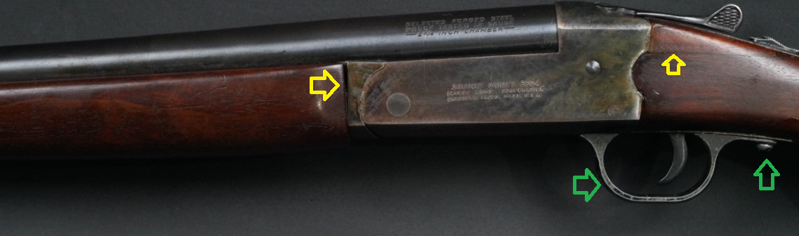

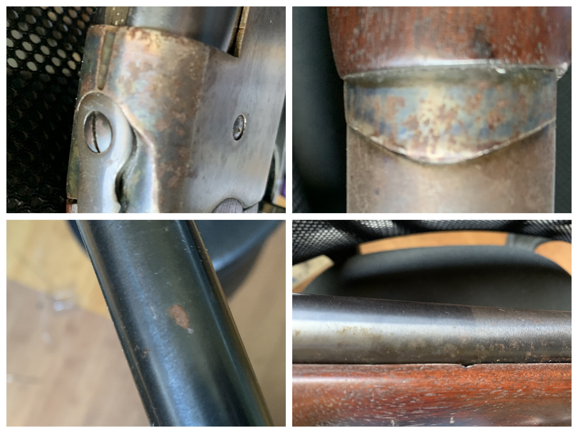

    IMHO - The metal of the OP's Steven's/Savage actually looks rather good. The 'case-color' on these shotguns was never very deep even when factory new.
    Any surface rust or dried crud on the 'blued' barrel and the case-colored receiver could easily be removed with #0000 steel wool soaked with Hoppe's #9. Use just a very light pressure on any surface spots and wipe with dry paper towel to review progress.
    The nice examples of case-color on guns, that others have provided, is not how Stevens-Savage budget shotguns appeared, even when factory new.
    I think greater blemishes on the OP's shotgun are the loss of black enamel paint on the 'Die-Cast' trigger-guard, what looks to be an incorrect replacement guard-screw, the slight 'tilt' in the forearm 'bracket', and possible cracks in the butt-stock wrist area.
    The trigger-guard could appear 'factory new', if removed and repainted with black spray enamel.
    The rear guard-screw could be replaced with (or recontoured to) a countersunk oval-head screw.
    The forearm bracket could be properly seated in the wood to eliminate the odd 'tilt'.
    If there are cracks in the stock wrist, these can be repaired and strengthened with epoxy bedding.
    Just saying, I don't think there is much wrong with original metal colors!

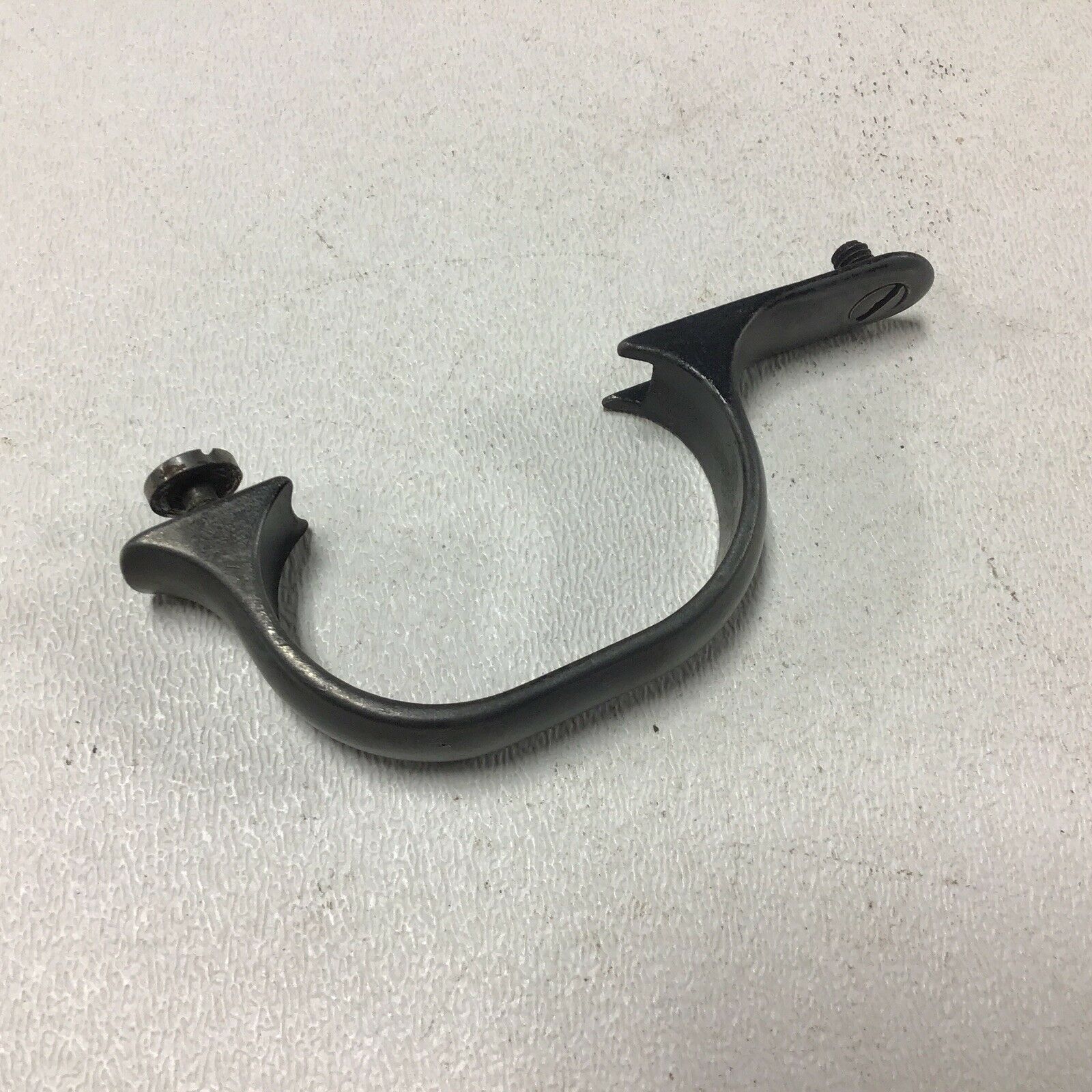

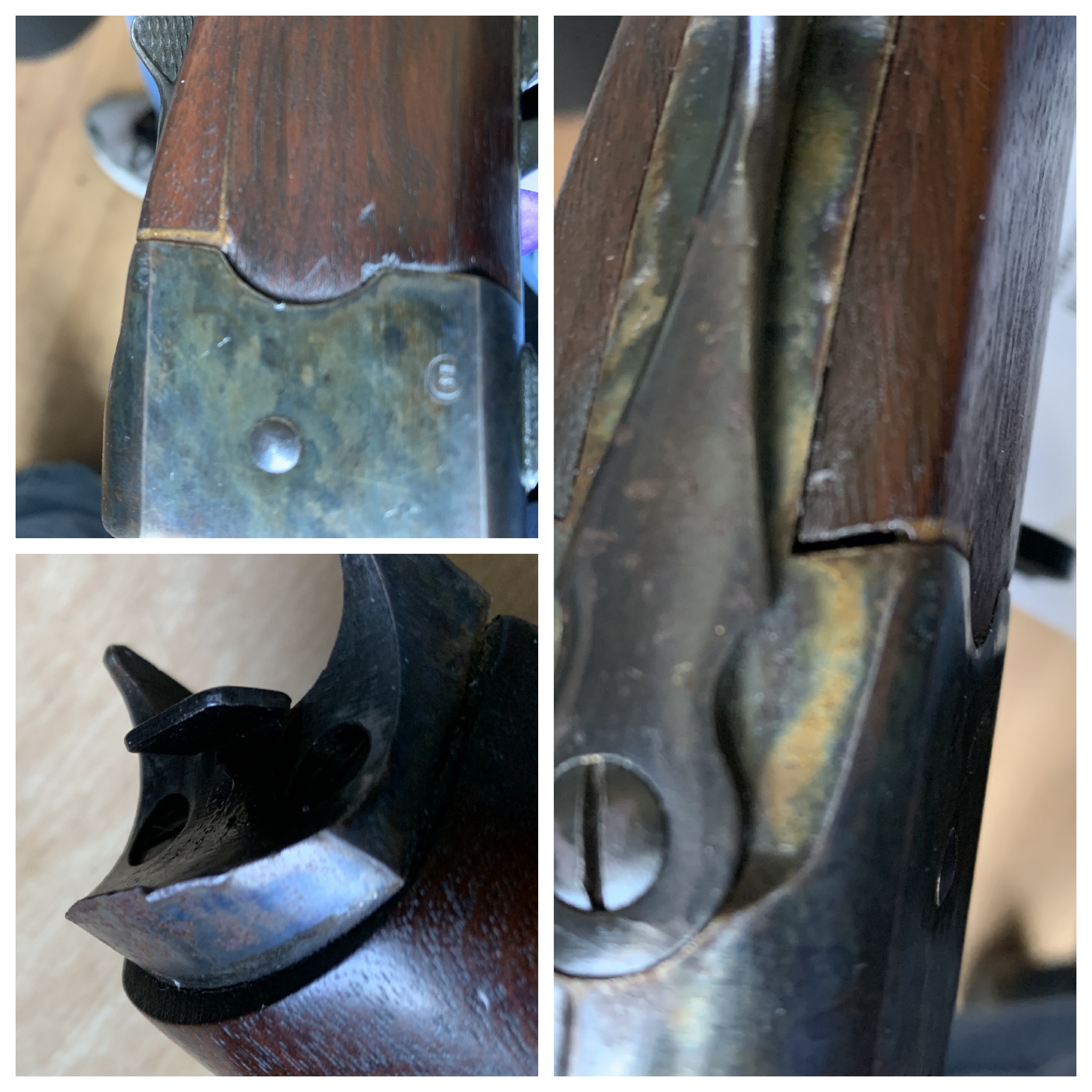

    Any surface rust or dried crud on the 'blued' barrel and the case-colored receiver could easily be removed with #0000 steel wool soaked with Hoppe's #9. Use just a very light pressure on any surface spots and wipe with dry paper towel to review progress. ... I think greater blemishes on the OP's shotgun are the loss of black enamel paint on the 'Die-Cast' trigger-guard, what looks to be an incorrect replacement guard-screw, the slight 'tilt' in the forearm 'bracket', and possible cracks in the butt-stock wrist area. ... The forearm bracket could be properly seated in the wood to eliminate the odd 'tilt'. If there are cracks in the stock wrist, these can be repaired and strengthened with epoxy bedding.
    The pictures do not really show the extent of the oxidation, the other side, top of the receiver, and various spots on the barrel have oxidation the hoppe's/oil and steelwool would leave those spots as white metal, and would not really "kill" the oxidation, only retard it. Thinking about your ideas and options, I could attempt spot steeming and light steelwooling as an alternative to a boil.
    I'm ahead of you on the trigger guard and screw I have a replacement coming. while looking for the correct trigger guard screw I found a person selling all original trigger guard with front and rear screws, I'm only hoping that the person who put the machine screw in did not rethread the receiver otherwise I'll have an additional repair to make.
    The stock has been repaired on both sides and filled on one. I haven't taken off the stock yet to really survey the repair, But do know at minimum from what I can see that the side filled, will need to be reworked. The forearm bracket (forend head piviot metal) does not look to be the one that came with the rifle and is loose. It needs to be peened back into the correct shape and as you said needs to be properly inletted to sit in the correct position when tightened down.
