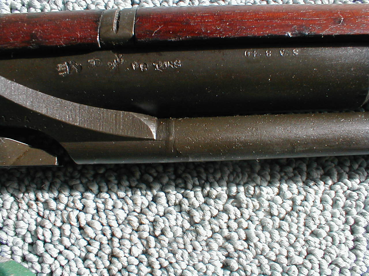

    Here are some photos to add to Jim's posting above:
    The first shows the BNP proofs on the receiver and right bolt lug area plus the rear barrel marks, The letter A was included starting in 1950 to the original Lend Lease imports.
    Last photo shows th London proofs on a S-A 8-40 dated barrel but is not among the original Lend Lease imports
