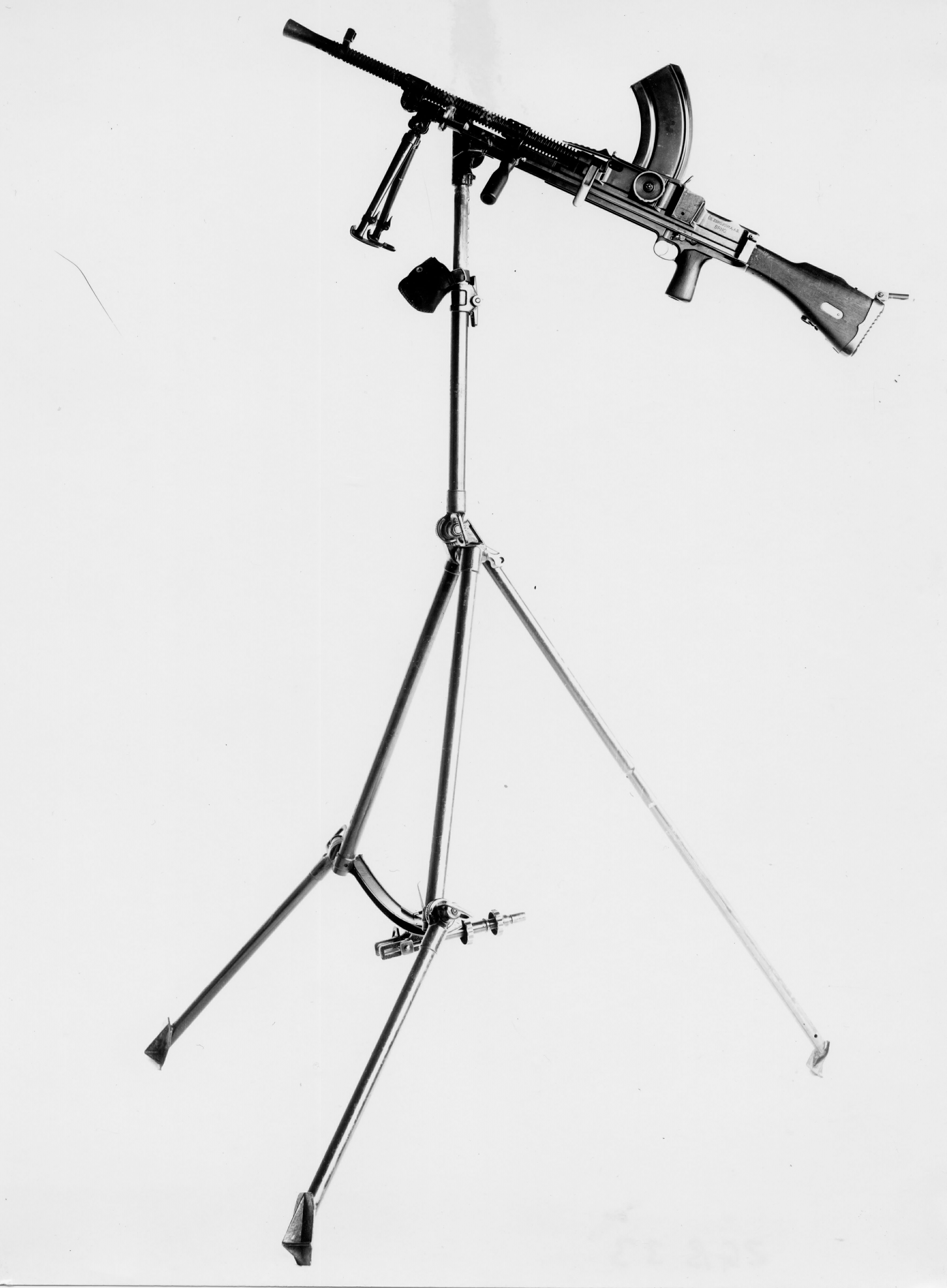

    ZB pic
    I moved the pic over. Click on with mouse to enlarge pic. Check out the dovetails. Note how the sight arm folds to the front.
    Might also notice ZB tripod.
    Later 42rocker
