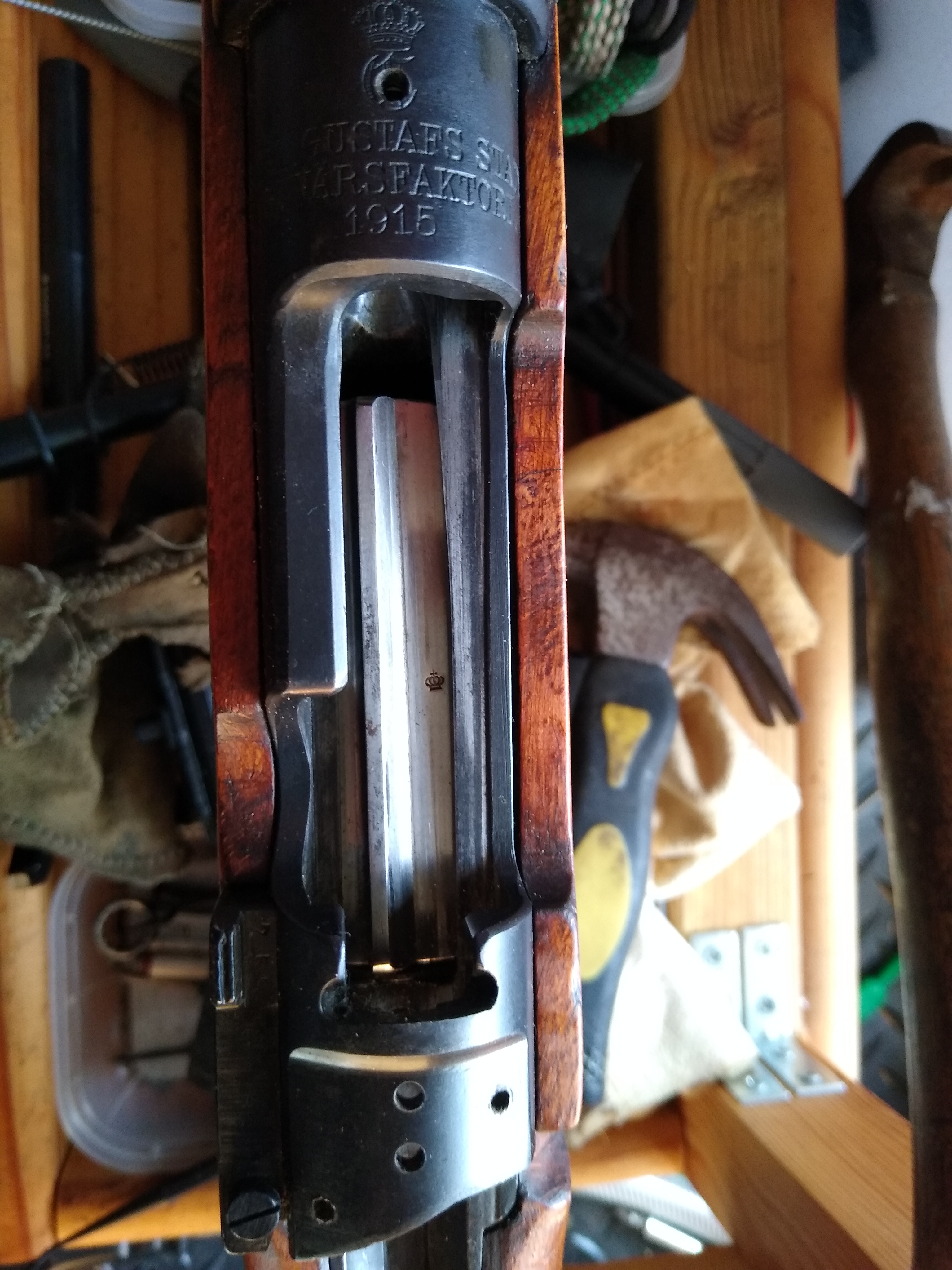

    This is the receiver with the holes drilled/tapped & I'm guessing it was for a aperture or similar sight &/or a rail?
    Any info on the hole spacing would be received with gratitude..

    Looks like it bore a one-piece scope mount post service.
    Can't tell what type. Measure center to center on the rear and to the single on the front and you might be able to determine which mount.

    Thanks for your reply.
    I guessed it may have had a rail of some sort...but was wondering about the other holes to each side.
    TBH I want to shoot with iron sights so the rail mounting holes are of no interest to me...but I may be interested in an aperture or peep sight at some point & was thinking that those other holes were for one...but I'd need to know the type that would use those threaded holes?
