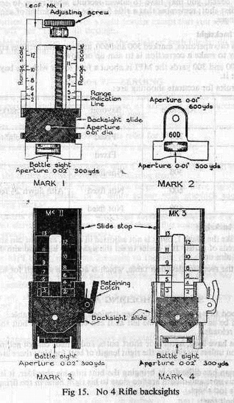

    If you would like to keep the concept of the Mk3 sight but would like a finer adjustment and more control, go get a Mk1.
    The Mk2 & Mk3 were basically cheap and quick to produce, still gave MoM (Minute of Man) and could be called war time expedients'
    You won't regret it.

    Are those rear sights numbered correctly in the picture Alan?
    I believe so - are you looking at the numbers stamped on them compared to the numbers 'below' ?
    Remember (this is the Britishicon military we are dealing with) & that it is the 'ladder' that is the marked part (MkII etc) but the complete sight is a Mk3 as there is already a MK2 (complete sight)
    OK, that explains it.
