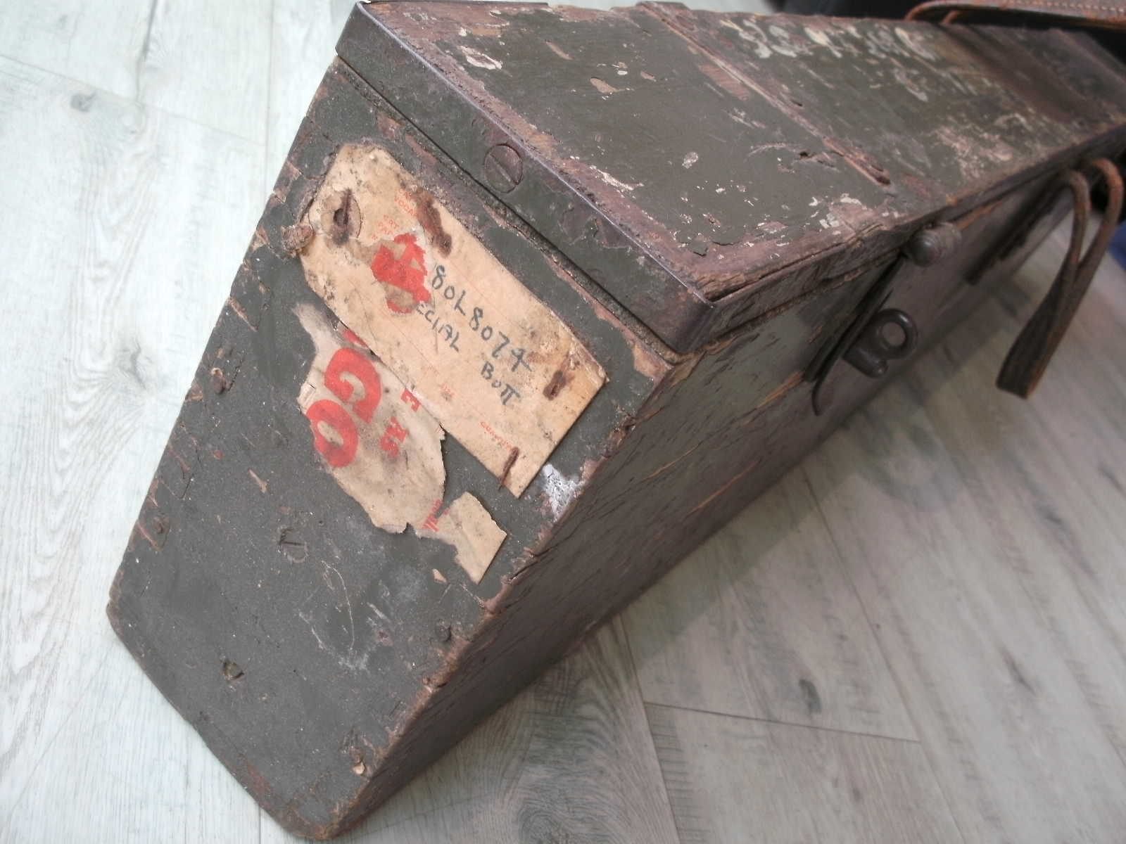

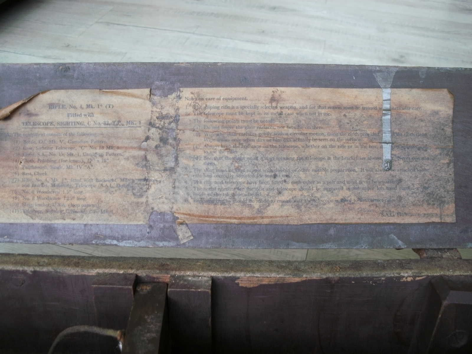

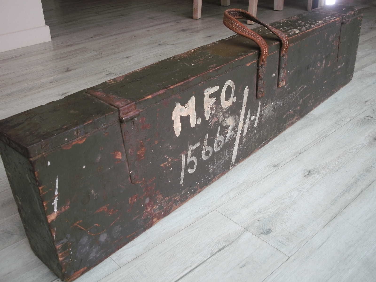

    80L8074 - transit chest for this rifle recently sold in NZicon.
    Chest marked "Special Butt". Photos from advert attached, inc contents list, scope C no32 TP
    I wonder where the rifle is now?

    [QUOTE=desperatedan;523759]80L8074 - transit chest for this rifle recently sold in NZ.
    This No. 15 Mk. I Canadian made transit chest is now safely back in Canadaicon. Although I have both an 80L8xxx and 74L0xxx among my No. 4 (T) rifles, my matching 74L0xxx "TRADE PATTERN" rifle is the one now assigned to this chest because of the special label inside the lid for the Lyman scope. Oddly this rifle and scope came out of Australiaicon and the chest came out of New Zealand.
    Of the 80L8xxx there were fewer thatn 104 made. Of the 74L0xxx "Trade Pattern" there were 350 (not 99) made.

    Could the chest have had two previous occupants? The label refers to the Lyman TP scope yet the serial number on the card on the end of the chest is for a CNo67 rifle (something that has eluded my best efforts for the last forty-five years, although I have the scope & rings!).
