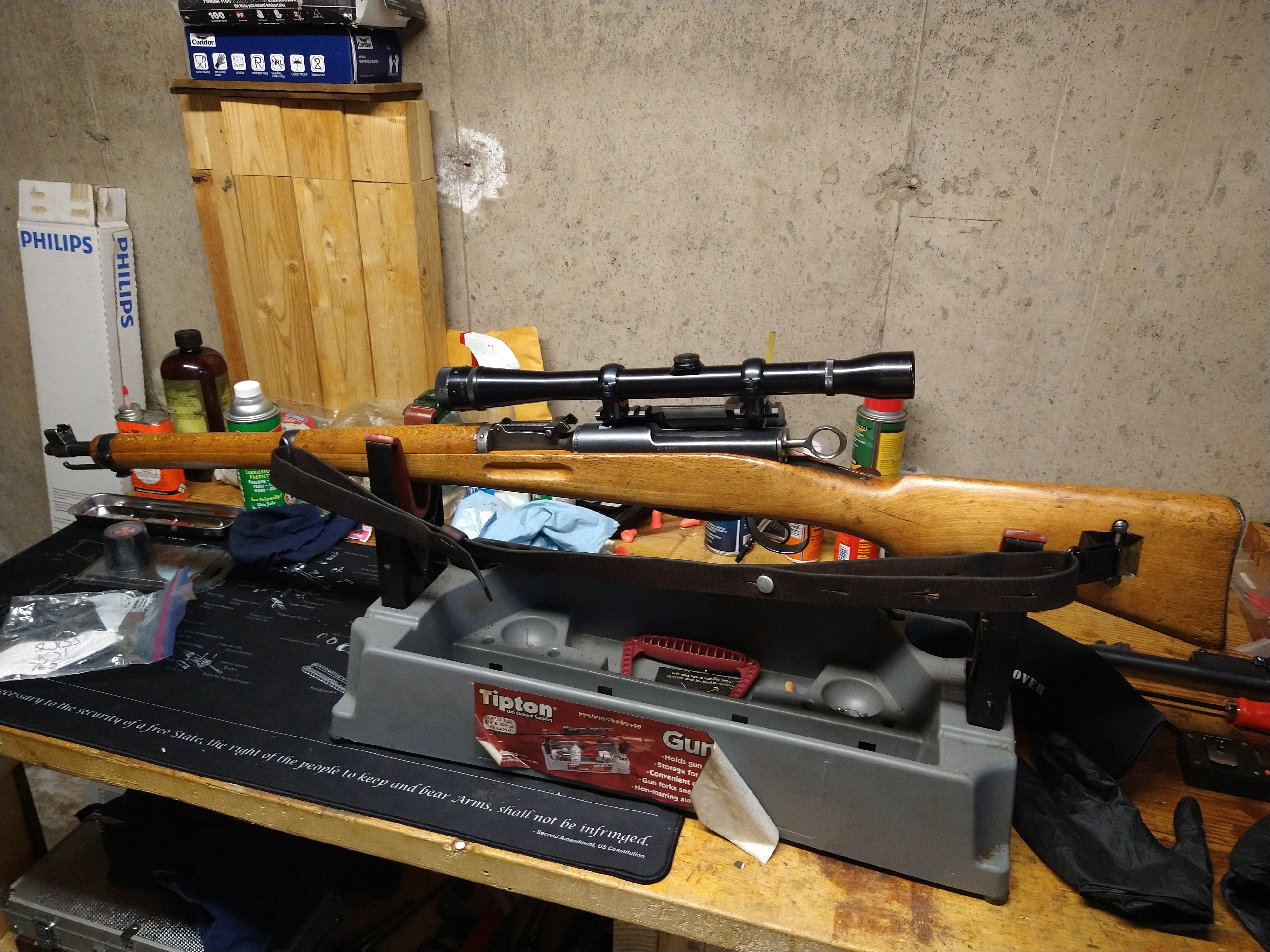

    I ended up buying one as well for a project K-31 I did over the summer. I have not taken it to the range yet but the install was very easy. It is a very well made mount and the deflector works very well. I didn't have to adjust it. I attached Burris Signature Rings medium height and a Weaver K10 scope on it.
    Once I get to the range I'll update this thread on how it worked.
