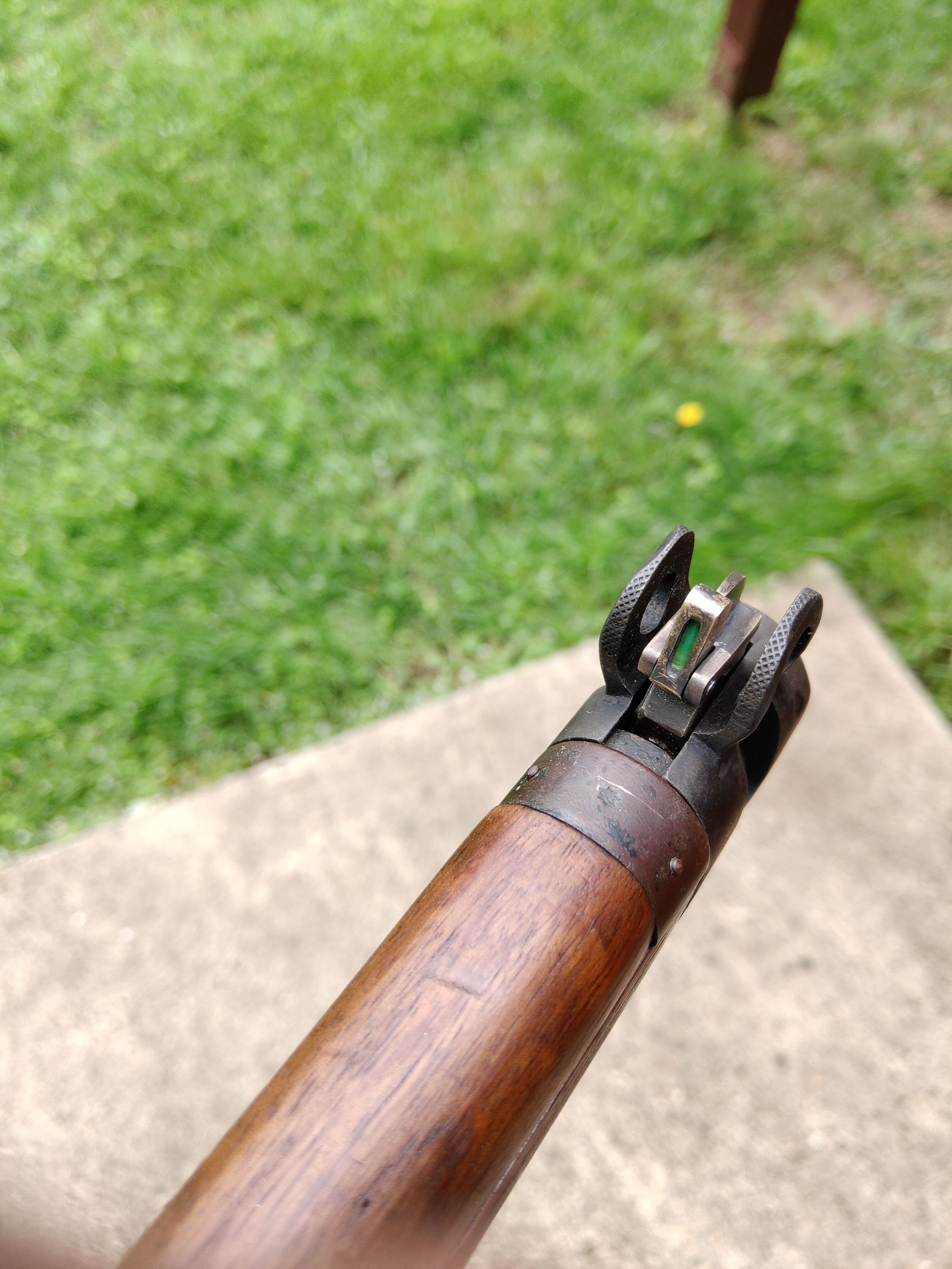

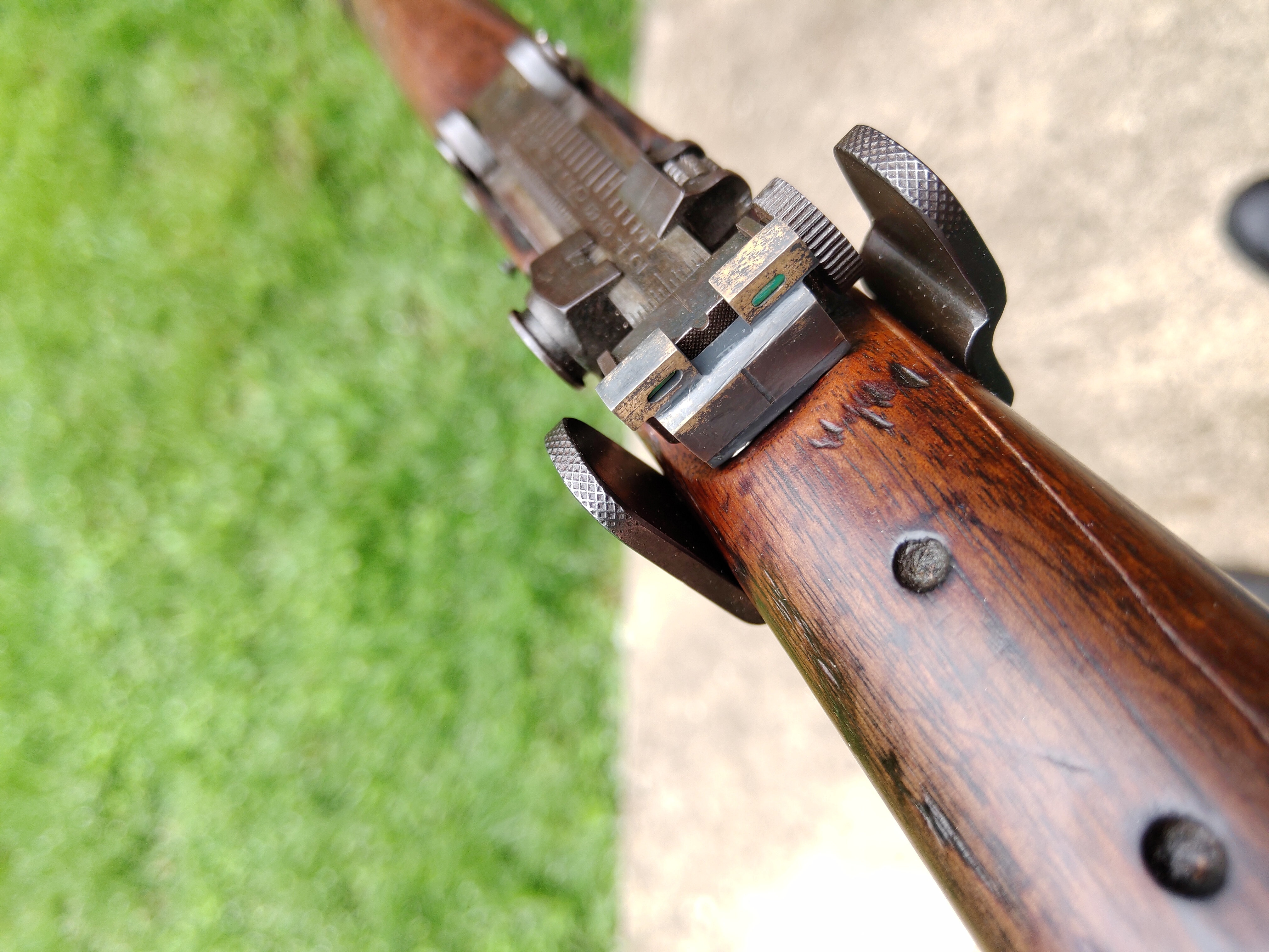

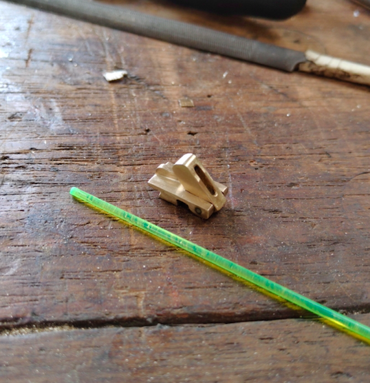

    SMLE Night Sight Update
    Hi All,
    Finally got some time between getting my mechanical engineering degree and work to build those night sights! They were a bear to complete and had around 5 iterations however happy with the final product. All done by hand with files.
    See attached some pictures from along the way and the final product attached to my 1915 Lithgowicon.
    Thank you to all who contributed, I am also close to completing my Purdy look-alike mounts for my original Aldis scope and will be sure to update!
    Cheers,
    Sam.

    Blimey! Well done Sam. The final result looks great, even down to the aged surface finish! I presume you will keep that for yourself?

    Well done Sam!! They look wonderful. We often forget what can be accomplished with had tools and patience!!

    Thank you Roger and Brian! (And everyone keeping up with the thread)
    Definitely keeping this set for myself, I have way too much time invested to be worth selling
    My custom Purdy mounts are about a week from complete, they are not 100% accurate as I took some liberties due to my rifle already being drilled and tapped for a field Australia mount (also wanted the scope to be removable from the mounts) but I still think they turned out really nice! Again, a bit of mill work, a lot of file work!
