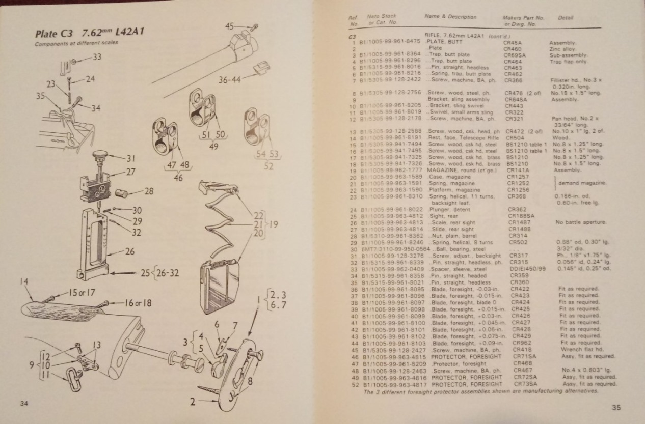

    I saw this plate from the pamphlet "SAIS No. 18, 7.62 mm L42A1......." by Ian Skennertonicon
    and there the leaf (scale) bears CR1487.
    The metric conversion must have taken place after 1965. Correct?

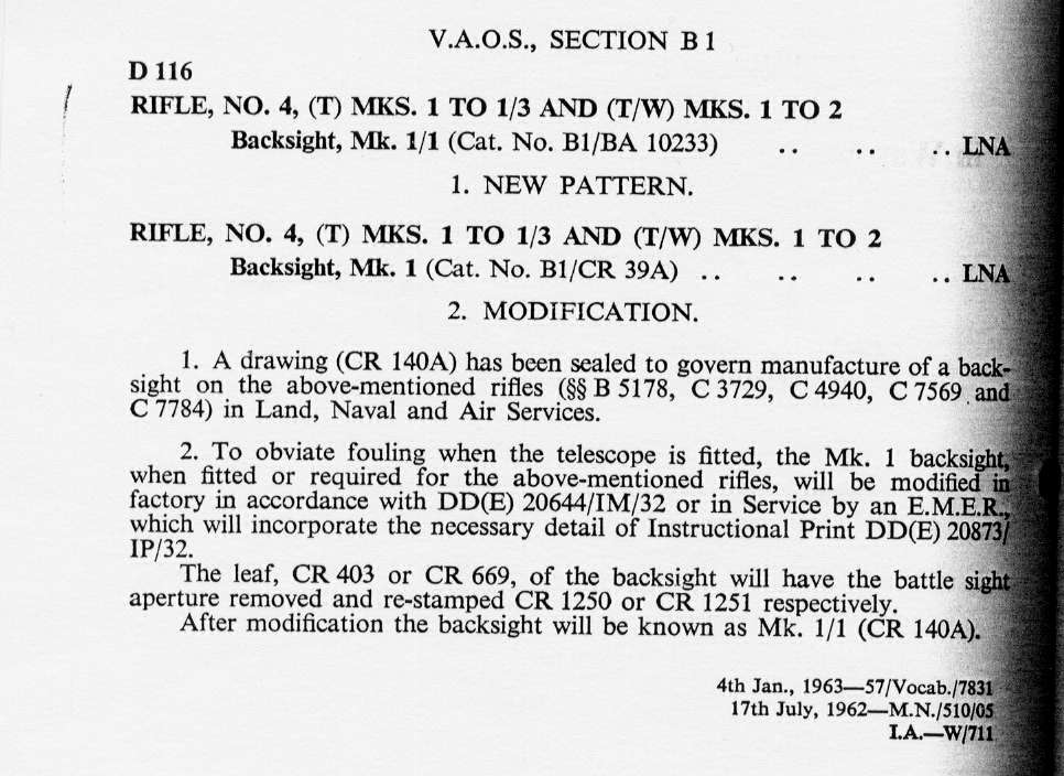

    Items 25 to 32 are the components of the rear sight (According to the military L42 Parts List - I have posted a copy of it some years ago into the Milsurps library) Each component has a CR number and the complete rear sight is item No25
Name:	Screenshot (1579).png‎
ID:	128357   Click image for larger version
Name:	Screenshot (1580).png‎
ID:	128358   Click image for larger version

    Looks as though 'new' CR numbers were in the main allocated, most likely when the parts went from 303 No4 to 7.62mm L42A1. At least, both the cursor & leaf have different numbers.....
