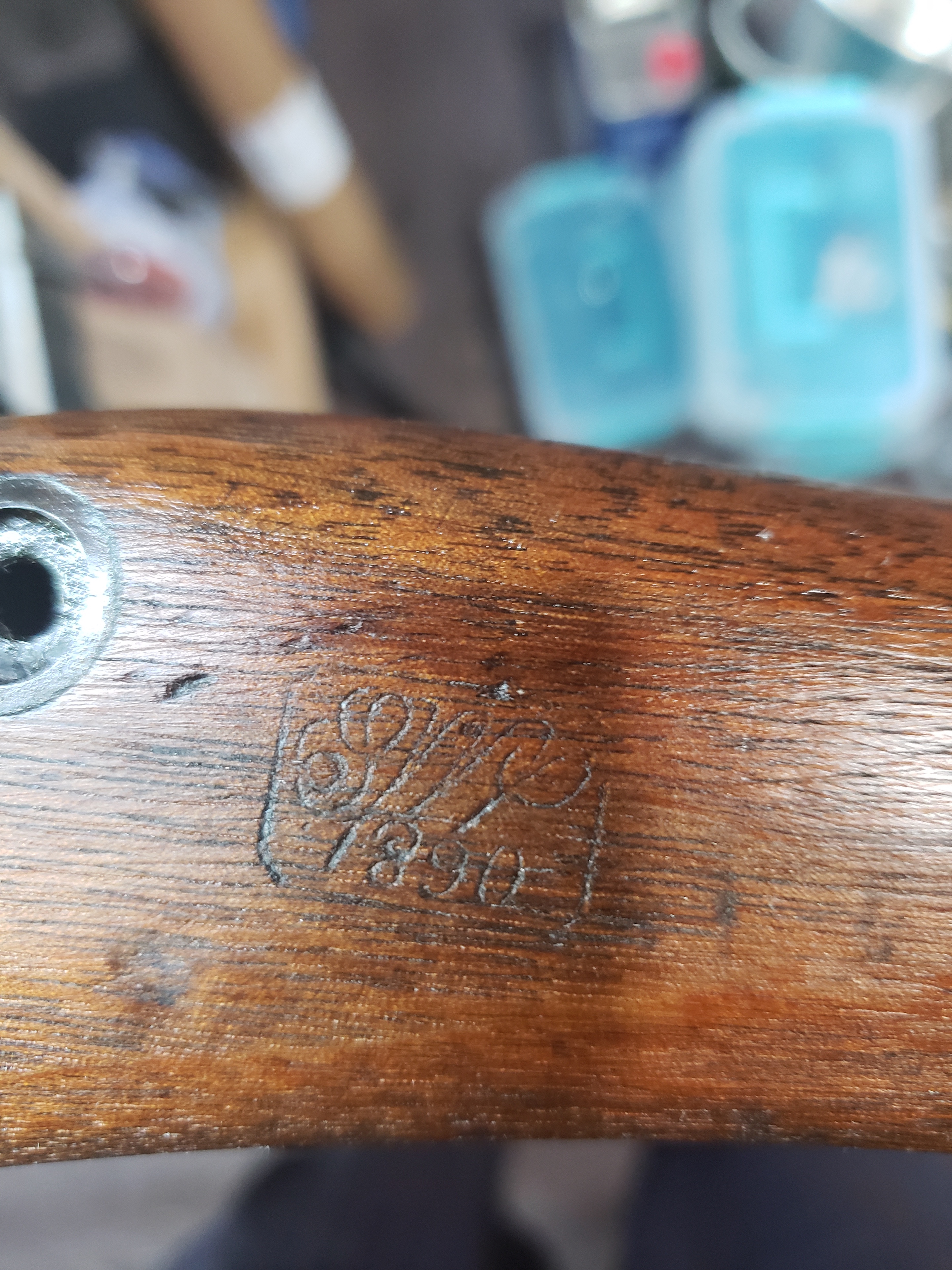

    Well, early to the range isn't going to happen, so last night I started working my magic on this. Everything came apart dandy with no issues, no splinters started around the usual tightly fired areas - likely the layer of varnish held everything down.
    With everything removed but the lock plate screw washers, I started on the side of the buttstock where you can see part of the finish missing. It seems like it was actually the remnants of a sticker. Not only was the top layer of finish not there, but there was gunky sticky residue around the area.
    I lightly rub with steel wool dipped in lacquer thinner, wiping frequently with a clean rag and lacquer thinner. At first, the finish turns in to a sticky mess, wipes away, then then slowly that area evens out with no more traces of whatever happened there. This is when we get to take a peak at what was originally there.
    Normally, as the top layer of oil and grime start to lift out, the wood takes on a bit of pink. This is the queue to stop as now the original linseed oilicon and patina is starting to lift. Gently wiping down with a rag damp with solvent moves that original color around. It gets into all the "new" scratches, and when you're all done in the end those look like the've been there for 130 years too. But This didn't happen. The sludge turned a thick brown color. It looks like my stock had been lightly sanded, stained with a birchwood Casey kit, and then heavy tru oil or varnish on top.

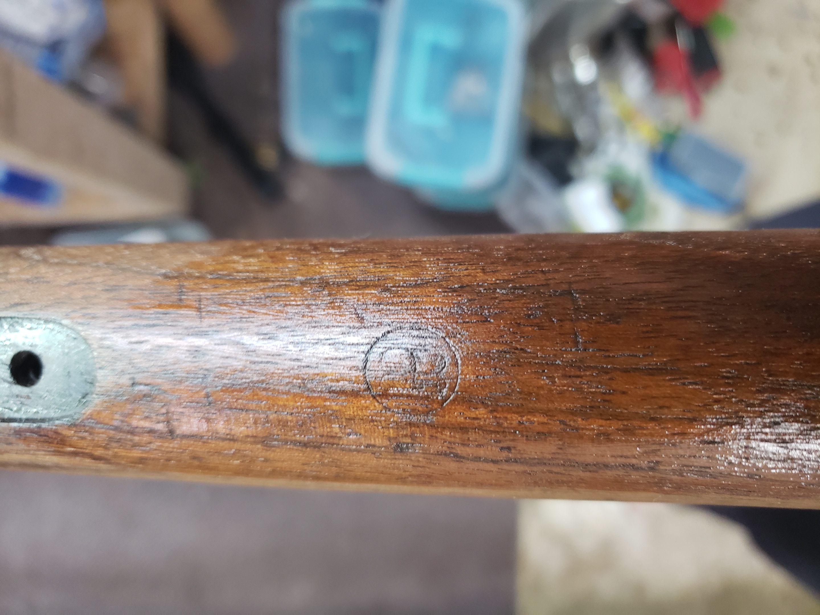

    So I have a mostly clean slate to work with...and look what I found that you couldn't see before...a proof mark, and the inspector's initials! all you could see before was barely the '189' in 1890.
    I'll keep gently at it with my method above until I'm happy what is left of the brown stain is at least even. Then, my home-made red oil should make it look like the finish was never touched in 130 years.
